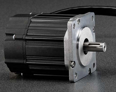

The goal will be to have a infinite loop with:
  • A spin of the motor from 0 to +50000 pulses with 5000 RPM plus a short wait time
  • Turning back the Motor into -32559 pulses with 1500 RPM of speed plus a short wait time
For this example I’m using:
  • Arduino Uno
  • Brushless Motor as teknic m-2310P-LN-04K This Motor has 8 Poles with an internal Encoder with 1000 physical lines pre-quad, meaning that in 1 turn rotation the motor controller will read 4000 pulses generated by this motor’s encoder in quadrature manner ( 4 times more)
  • Solo Uno as motor controller used as servo drive.
To make it work, I also use the Library for communication between Arduino and Solo, more info here.
