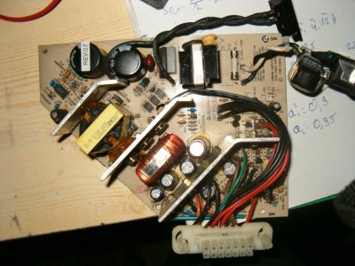

Step 3: Disassembly
So you got your power supply. Time to take it apart!
Notice: Be careful! Sharp objects may cut you inside, wear gloves and googles! Do not service anything while it is plugged in!
There are standard Phillips screws everywhere, take those out.
Cut the wires coming out of the box.
Then open up the item.
Unscrew the board from the base, and remove the base after cutting wires to the fan and the AC plug and the grounding.
Remove the board.
Congratulations! Base material is ready for transformation!

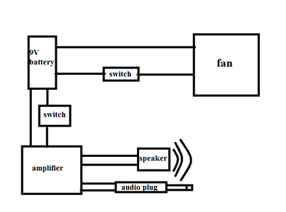

Step 5: Electronics
Now that the paint dried, time to install the fan and the sound system!
First, measure cable distances where you want to place your items. I put the amp in the lid part, and the speaker naturally to the exhaust grill. Solder the wires according to the image. The audio plug should be soldered in a way that the plug's outer core/biggest leg/ground is soldered to the 'GND' sign of the board. Otherwise just watch polarity to make things work!
Once you hooked everything up, hot glue all the parts in place according to the image. I used the corners to get a good grip and to hide wires a bit. Install the speaker, mine fits snugly into its place! Put in the switches, battery holder, etc.
