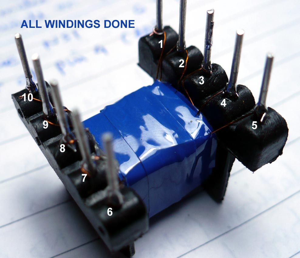

The approach
In order to measure the frequency of the power signal of such a high magnitude, the amplitude needs to be brought down to a lower magnitude so that the signal can be
fed to the microcontroller. However the frequency is kept unaffected. This can be done in the following steps:
1. Using a 230V/6V step down transformer, the voltage is first brought down to 6V.
2. Now, using a potentiometer the voltage is adjusted to 3V rms value (Vp-p = 3√2 ≈ 4.25 < 5V).
3. This signal is now fed to one of the analog pins of the microcontroller.
Now we have been successful in giving the modified signal to one of the analog pins of the micro-controller.
