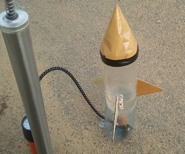

Step 1: Making the Fuselage
Draw a line straight up 2cm from the left side of the paper and another line 5cm from the right side. Roll the A3 paper lengthwise along a 1/2" pipe and then mark where the end edge of the paper meets with the rest of the paper(Please refer to thr pictures above). Unroll the paper and draw a line lengthwise along the mark you've made. The paper should now be divided into 6 parts. Use a ruler to divide the bottom right part lengthwise into three parts. These lines will be used to align the fins. Draw a line straight up 2cm to the left side of the middle bottom part(box) and divide it into four equal parts using a ruler,this will be the support arm alignment template. Roll back the paper into a tube and seal the edge with sellotape. Next, push the remaining pvc pipe into the paper tube until it reaches the top 2cm mark you've made and then push the paper inward to close the top of the tube. I used hotglue to seal the top.

Step 5: Making the Launcher
I designed the launcher in a way so that i could use some parts i had from a previous project. You can modify the design as you wish but keep in mind that the ball valve needs to be between the air tank and the launch tube not between the air supply and launch tube. The launcher has an airtank so that a larger volume of air can be stored and then supplied to the rocket at an instant when the ball valve is opened and a removable launch tube for easy storage and for launching different sized rockets or multiple rockets.
Use a hacksaw to cut the pvc pipe into two 15cm long tubes, 8cm long, and two 4cm long pieces.The remaining length of the pipe will be the launch tube. The remaining length of the pipe will be the launch tube. Connect the two 15cm tubes together with a t-joint. Glue the 8cm long tube to the bottom of the t-joint. Your halfdone launcher should now look like a giant letter T. Next drill/make a hole about 1cm wide at the center of the pvc end cap. Push the schrader valve through the hole and use a plier with a piece of cloth wrapped around the valve to pull and wiggle the valve stem(not thread) in place until the groove on the stem gets sitted on the cap. Glue this to the bottom of the uncompleted t-shaped launcher.
Step 6: Airtank and Release System
Since the airtank we're gonna be using here is a soda bottle, then you'll need a way to connect the bottle to the pvc pipe. To do this, i simply cut round the inner circumference of the ring in the bottle cap which turned out to be a perfect fit. Sand the bottom of the bottle cap with a rough grit sandpaper and also one side of the pvc elbow so as to have a rough surface for epoxy to adhere to. Glue the 4cm long pipe into the sanded end of the pvc elbow and then push the bottle cap into the pipe. Secure everything in place with epoxy.Use a generous amount of epoxy as mine gave way and launched the Airtank Skyward while testing. Let everything dry and then glue it to the left side of the gigantic t-shaped launcher.
For the release system, simply glue together the ball valve and the other pvc elbow with the 4cm tube connecting them together. The open end of the pvc elbow should face to the left while the handle of the valve should face towards you. Glue this section to the right side of the launcher. Squirt some lubricant onto the valve where the valve handle enters the body.This will loosen the valve and make it easier to open/close. You can now insert the launch tube into the other end of the ball valve but do not glue it in place as this part of the launcher won't be pressurized. The launcher is now complete. if you want, you can attach the final launcher to a sturdy base(in my case MDF wood).

Step 8: Test Flight
My first attempt to launch at 30psi was succesful although the parachute got tangled, it did manage to bring back the rocket safely to the ground. Also i wrapped the parachute too tighly,i guess that's why. On the second launch, the parachute did not deploy, after having a closer look, i figured out that the parachute got stuck inside the nosecone(too loose). Despite the hard crash, it was still in good condition. My third attempt at 50psi was a complete success, fast,powerful launch and successful recovery. I will launch the rocket at night in three days time. So remember to check back.
