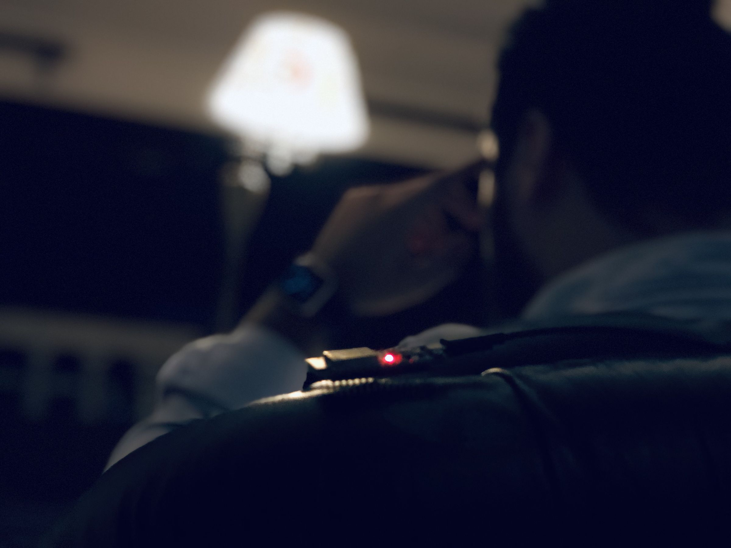

Introduction: Presence Sensor
Wearables are usually BLE enabled devices. It is common for them to periodically advertise some data along its MAC address. We use an ESP to scan these data and trigger an event through internet when it finds a specific MAC address.
This particular implementation is for a single user on a smart plug connected to a lamp. But it also can be used with a set of registered devices with any kind of IOT enabled devices.

For this example, I will be using my Apple Watch to trigger a smart plug to turn on a lamp when I sit at my desk.
