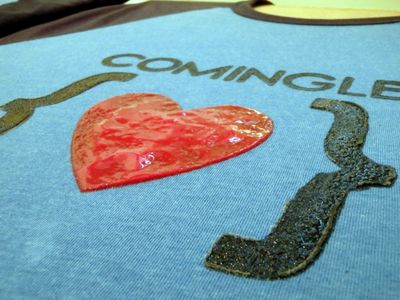

After months of working with Silicone and being frustrated with how much clothing we've ruined by getting weird goops onto it, Andy finally had the realization that this might actually make silicone a really good material to print with!

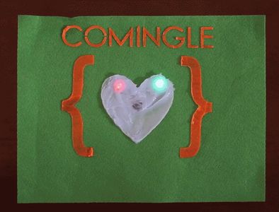

So a few days before, preparing for Arse Elektronika 2014, we tested it out and it worked great! This printing process has a couple key advantages over other fabric printing processes I have played around with:

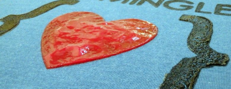

Durable - It's pure silicone bonded with your fabric and it is heat and water resistant! Haven't noticed any kind of fade in the fabric from old stains.
Textural - Depending on how you apply the silicone you can get different textural patterns. You can make it nice and smooth, get tattered edges, or even have a spiky texture all over it.
Structural - Because you can apply it with some thickness, you could more securely and waterproofly mount e-textiles into your clothing while maintaining their structural integrity. You can alter the silicone's opacity and internal reflectance (with stuff like Glitter) to create nice glow patterns with embedded LEDs.
Protective - This printing not only looks neat, but it can also reinforce parts of your clothing that might be in high-impact zones.
Quick! - The silicone we use is fully set up in just an hour. Your shirts are ready to wear really quickly and won't take up tons of drying space and also don't need a final ironing to make them stick like many fabric paints.

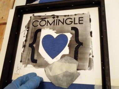

Put your shirt (or whatever you're printing on) on a nice clean flat surface. Load your flat underboard inside it (this is important: it will keep one side of the shirt from bleeding onto the back). Now tape off the edges of your stencil to keep it in place. And, if you are doing a two-part stencil, tape off the regions for the final color.
Keep a flipped up tab of tape wherever you have parts of the stencil marked off.
When you are taping off a specific part of the stencil, make sure to fold some of your tape up (as shown on the heart in the design). Once the silicone has been squeezed over the design, it will get gross and hard to pull up. This little tab will help you out!

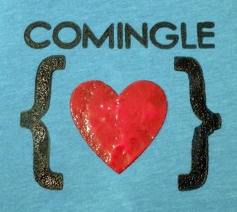

The silicone is a bit unlike regular screen printing where you want to apply a nice smooth line near the design (but not really onto it). If it is as least a little bit thick, and your stencil is firmly in place, try to loosely glop the silicone into the design directly. Have your squeegee (or Popsicle stick) near by, as you will quickly begin to distribute your silicone mixture all over the design smoothly. Start by pressing hard to make sure the silicone gets everywhere, but then start to squeegee lightly on your final pass, allowing for nice thick letters. You don’t want the silicone piled up above the stencil. Squeegee excess silicone from your stencil and place back in your disposable container.

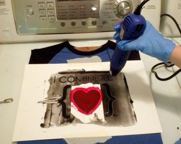

After applying your silicone mixture to your design, blast the design
for 20 seconds with a heat gun. You will then begin to carefully peel the stencil off. Once your stencil has been completely removed, take your heat gun and blast your entire design again for about 30-60 seconds.

Step 7: (Advanced) Embed Electronics
Silicone printing could solve a lot of problems with e-textiles
(waterproofing components, stopping threads or wires from moving, or getting shorted, and adding structure for haptic interaction). We haven’t tested this that much, but plan to do so in the future! Once we get good conductive silicone going, you can imagine printing squishy stretchy circuits right onto your clothing itself!
Meanwhile you can pop electronics under the silicone and just print right over it. The silicone makes nice diffuse light for basic LEDs that you put inside!
