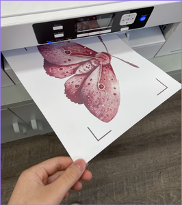

Step 7: Go to Sublimation Printer and Load Heat Transfer Vinyl (glossy Side Up)
Step 8: Click "send to Printer" and Select "SAWGRASS SG1000" Then Print!
Step 9: Grab Paper From Printer at the Corner
Do not touch the ink as it will smudge!

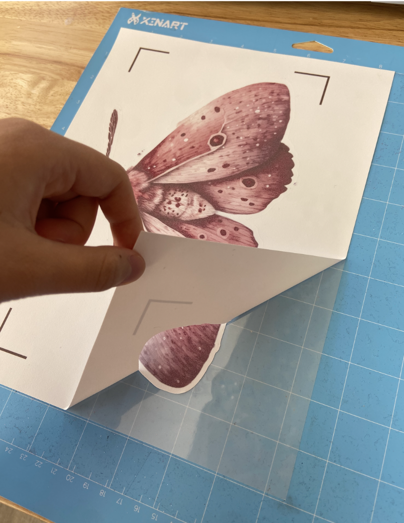

Step 10: Stick Printer HTV on to Corner of Sticky Mat
Tip: Be as close to the grid marks on the mat
Use a squeegee to stick HTV onto mat, making sure not to touch the ink as it will smudge.

Step 16: Carefully Peel Away Waste Paper

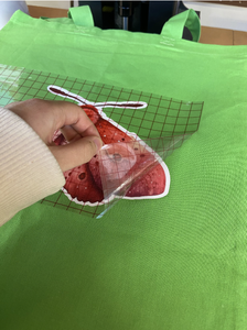

Step 17: Cut Out a Sheet of Transfer Paper
Step 18: Apply Over the Cut Heat Transfer Vinyl
Use a squeegee to evenly stick it on

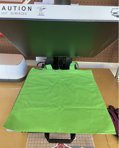

Step 19: Set the Heat Press to 310 Degrees Fahrenheit and 15 Second Duration
Step 20: Place Bag on Heat Press and Stick HTV With Transfer Paper on Bag
Step 21: Press the HTV Onto the Bag

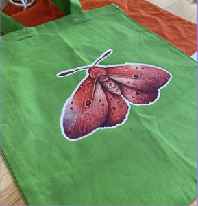

Step 22: Remove Transfer Paper and Bag Is Finished!
