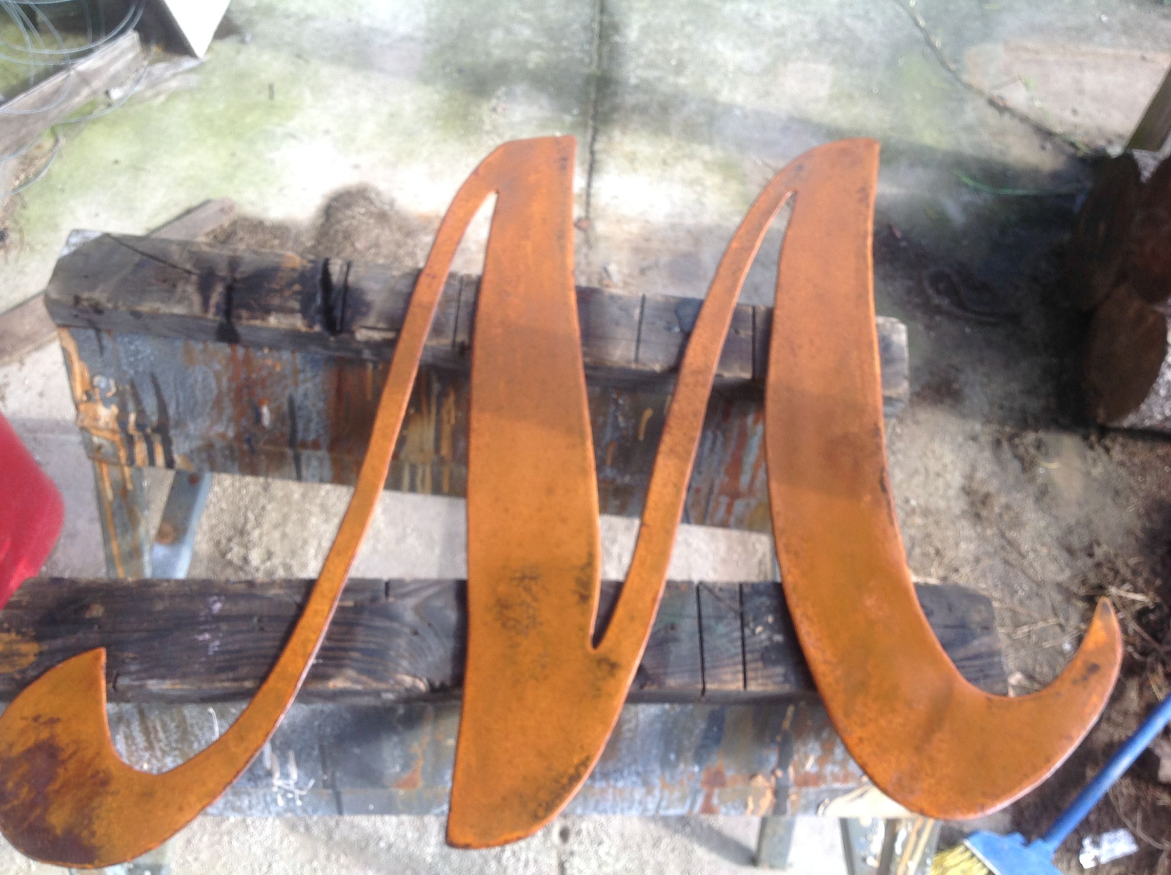

Thank you. It worked well on mild steel sheeting. I degreased the steel and painted this with enamels. when the enamels were dry I carried out the rusting process. I was able to achieve the amount of rusting I needed. The enamels were not damaged. I finished off with a wax polish. The sort that is generally used for wood.This gave a lovely soft finish.

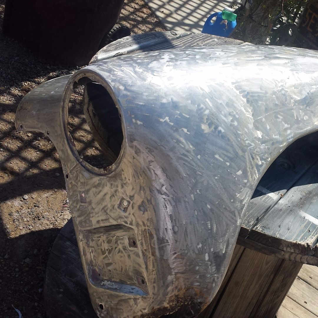

Hi - I have started a new signage project, the sign tray and its frame are constructed from fresh coreten, I want to get the lovely rich patina before installing but have a query I'm not sure if anyone can help with. On the face of the steel will be cut acrylic letters which will be VHB taped on. I'm thinking that this should be done whilst the steel is fresh and clean but concerned that the accelerator solution will strip away the glue from the tape. I have a few "swatches" to test it first, but if anyone has any thoughts or ideas to throw into the mix I would be very grateful! - Cheers

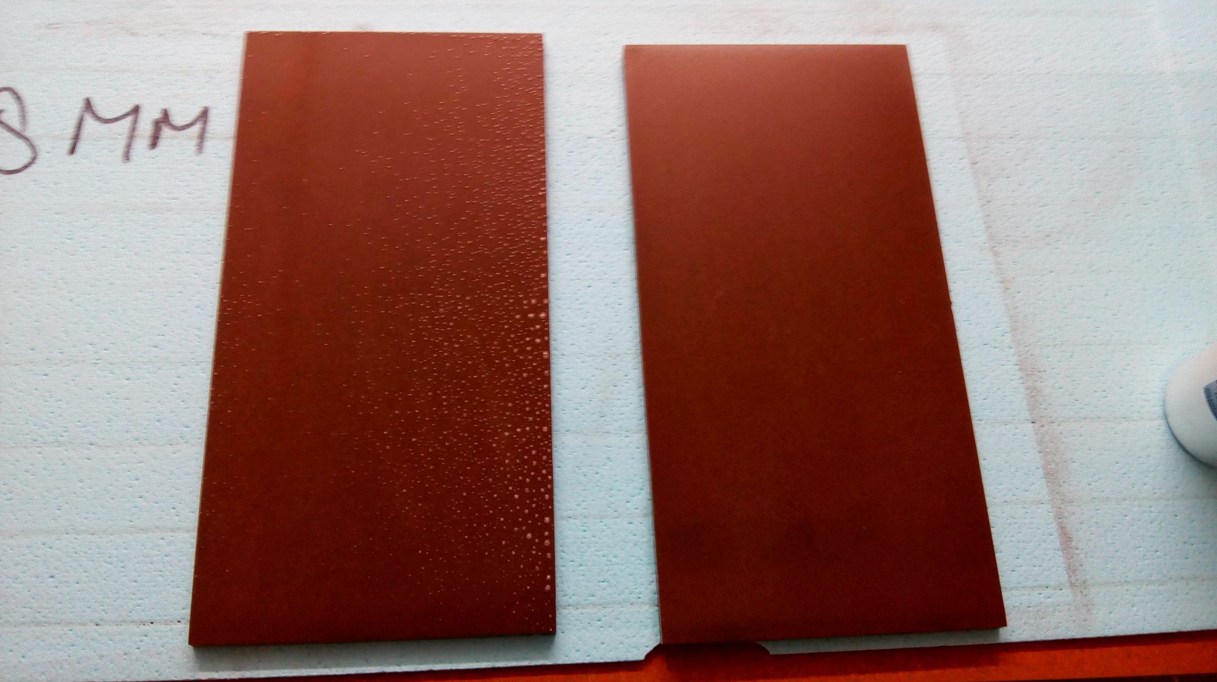

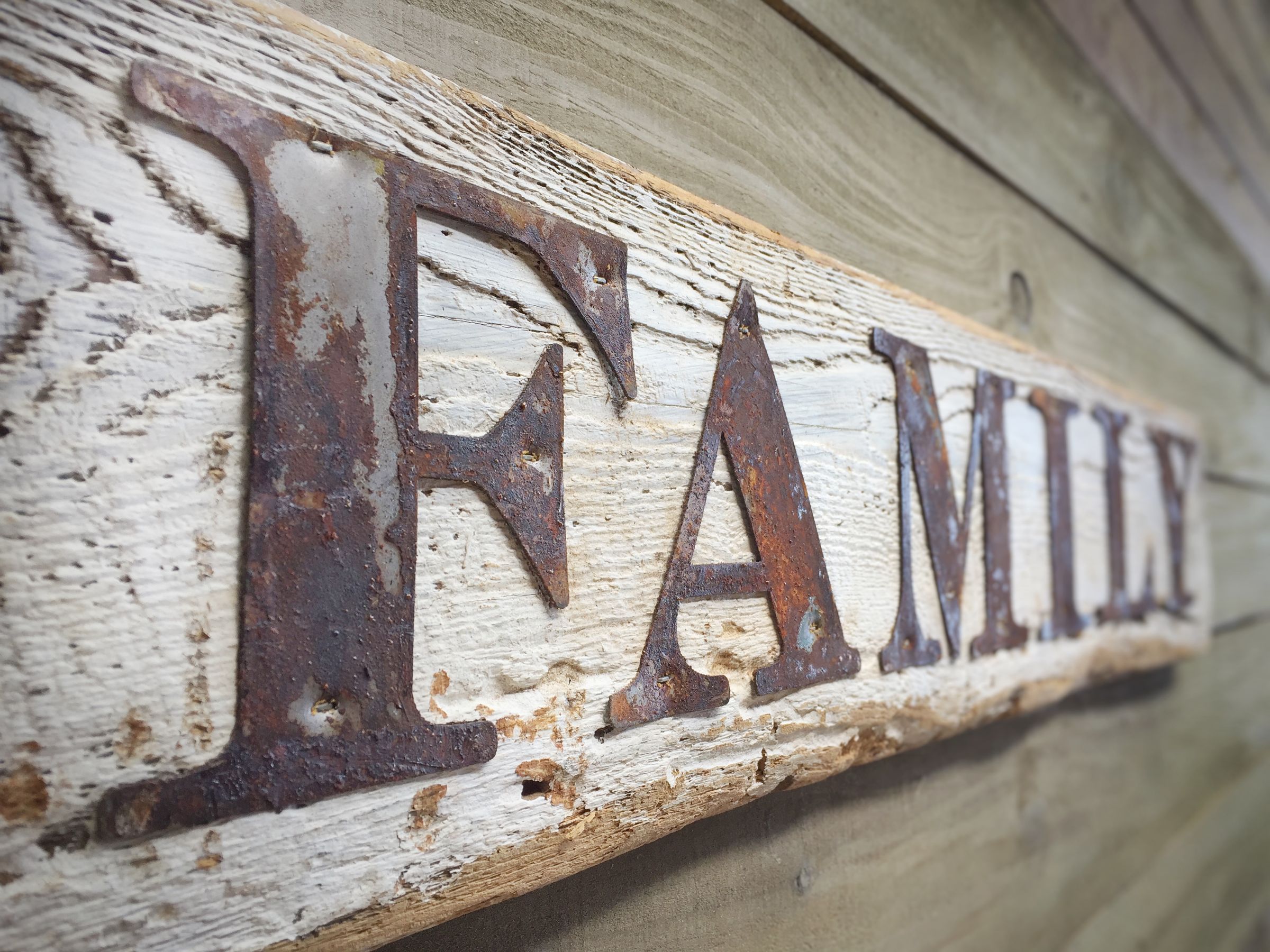

makieme
makieme
5 years ago

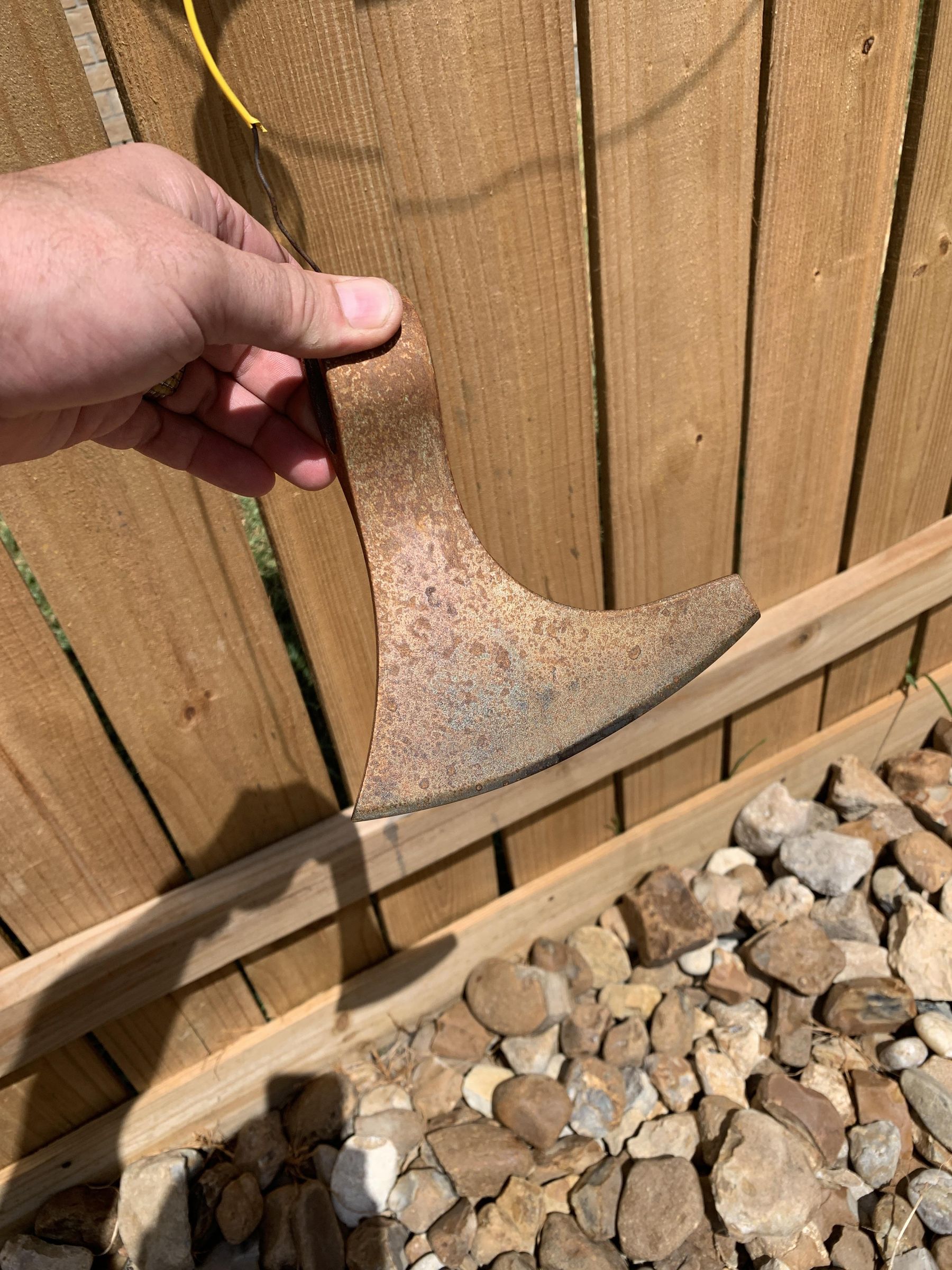

I've been using your method and love the orange patina achieved by submerging the steel in the mixture. However, I'm finding it creates an excess amount of rust dust later. Is there a non toxic way to stop this process? I can't clear coat as I'm working with far too many pieces. The other look I love is the acid wash look (similar to SusieL15), which I believe wouldn't cause all of the dust. However, I don't want to use chemicals. Do you have any advice? Thanks!

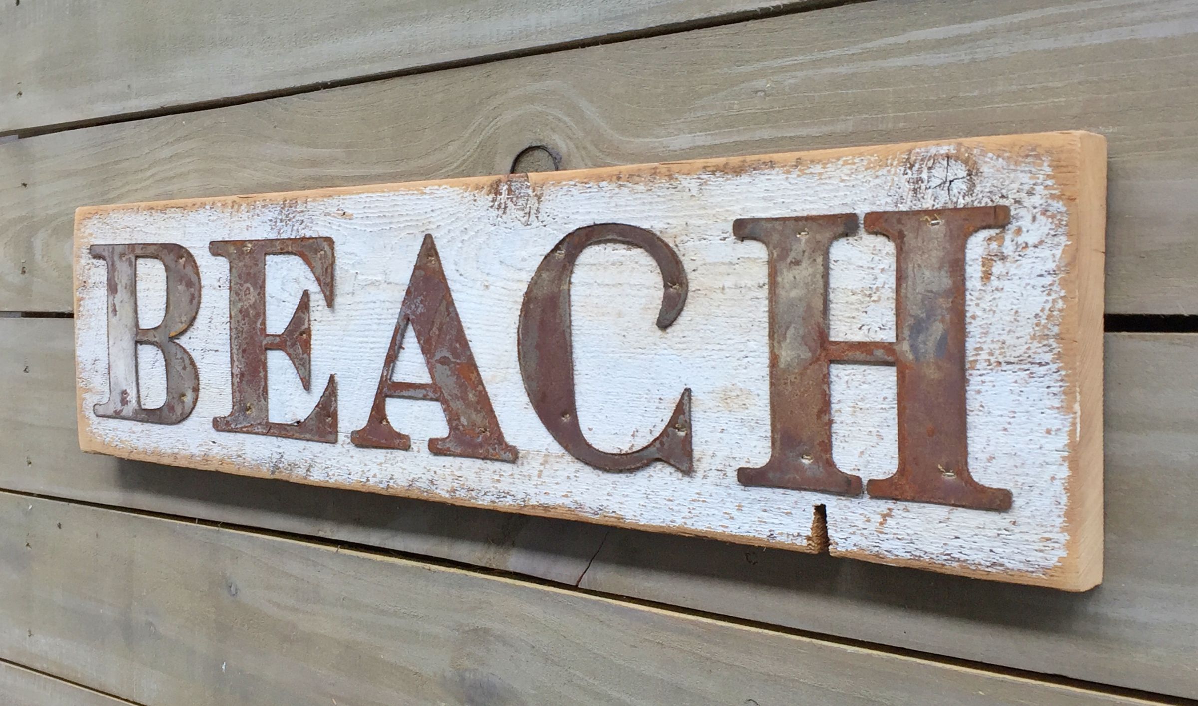

5 years ago

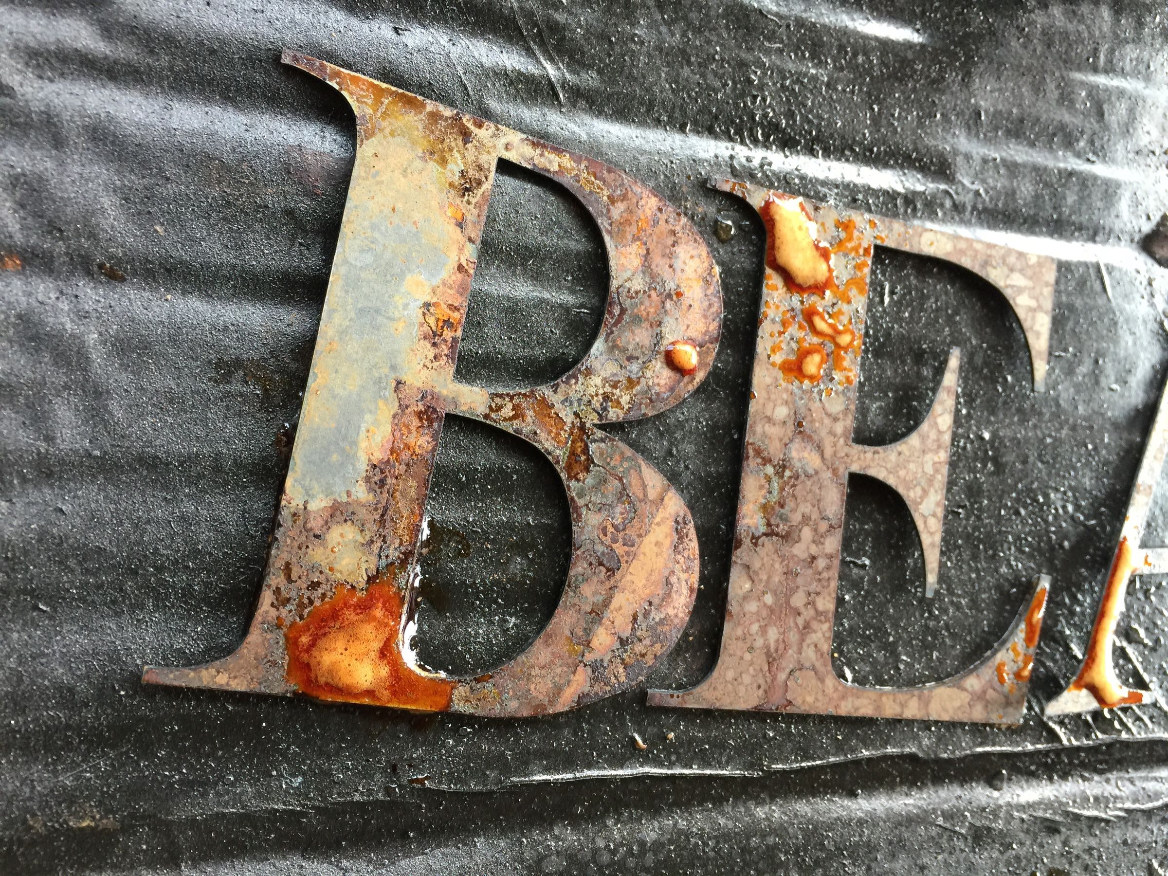

Thanks for the easy to follow instructions! I've used it on letters for barn wood signs and LOVE the look!
0
makieme
makieme
Reply 5 years ago
Hi Susie, looks great! How did you achieve the variegated look?
0
Laral
Laral
Reply 5 years ago
Looks great! I like the variegated look. It looks more natural.

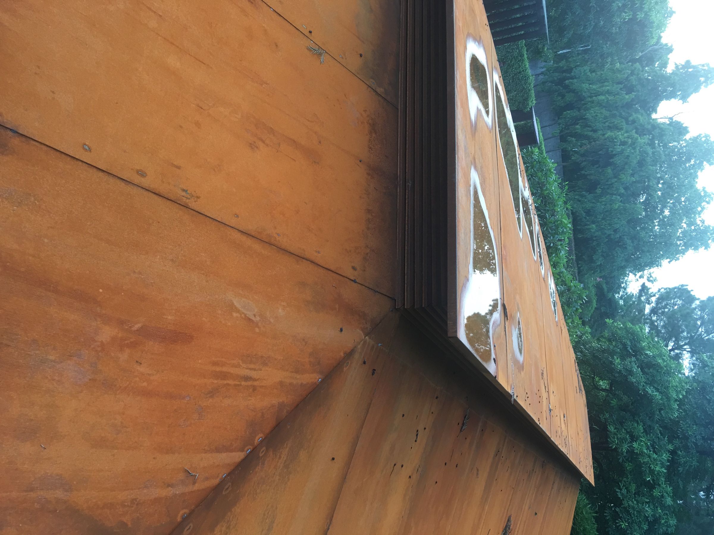

Thank you for the detailed explanation! I used the steps described to accelerate the rusting of bended Corten steel metal and made a timelapse video of the process. Perhaps it is of use to anyone:
0
Laral
Laral
Reply 5 years ago
Thanks for the video!

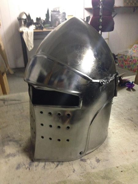

DELTA_117
DELTA_117
5 years ago

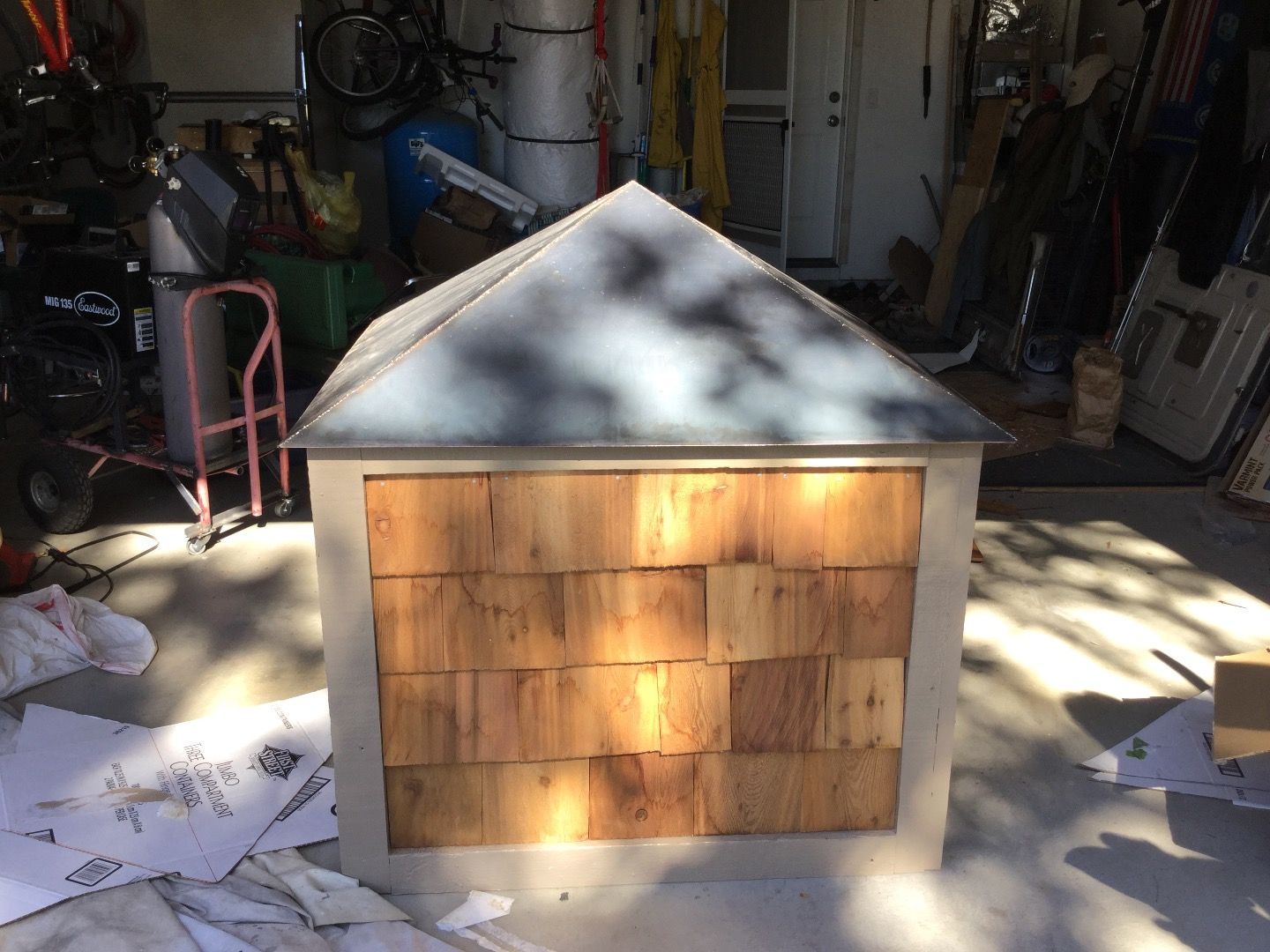

Hey, this is really great, thanks for that! I want to achieve this look, I was wondering if you would recommend against doing this for (what I think is) a steel helmet from a functional perspective, just in terms of something that gets handled a lot, assuming it can be done at all. My thinking was to do this, and then apply a fixative as you said. Thanks!
0
Laral
Laral
Reply 5 years ago
Sorry for the delay. I haven't been getting notifications for comments.
I see no reason not to do it. Keep in mind, it will be powdery at first and comes off easily. A fixative is good or you can let it stand around a while and let nature take over. You could spray it with water every day to accelerate the process.

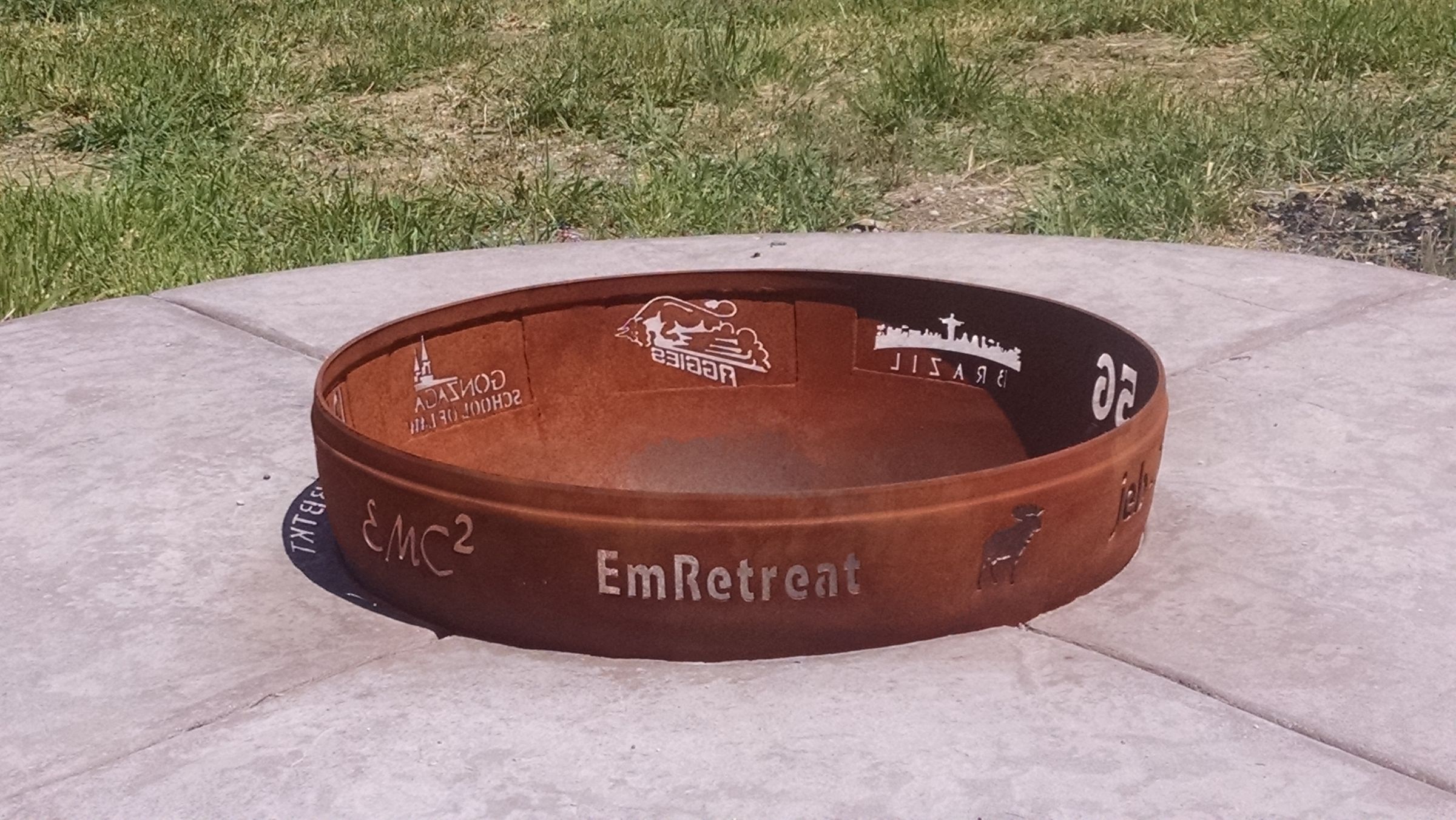

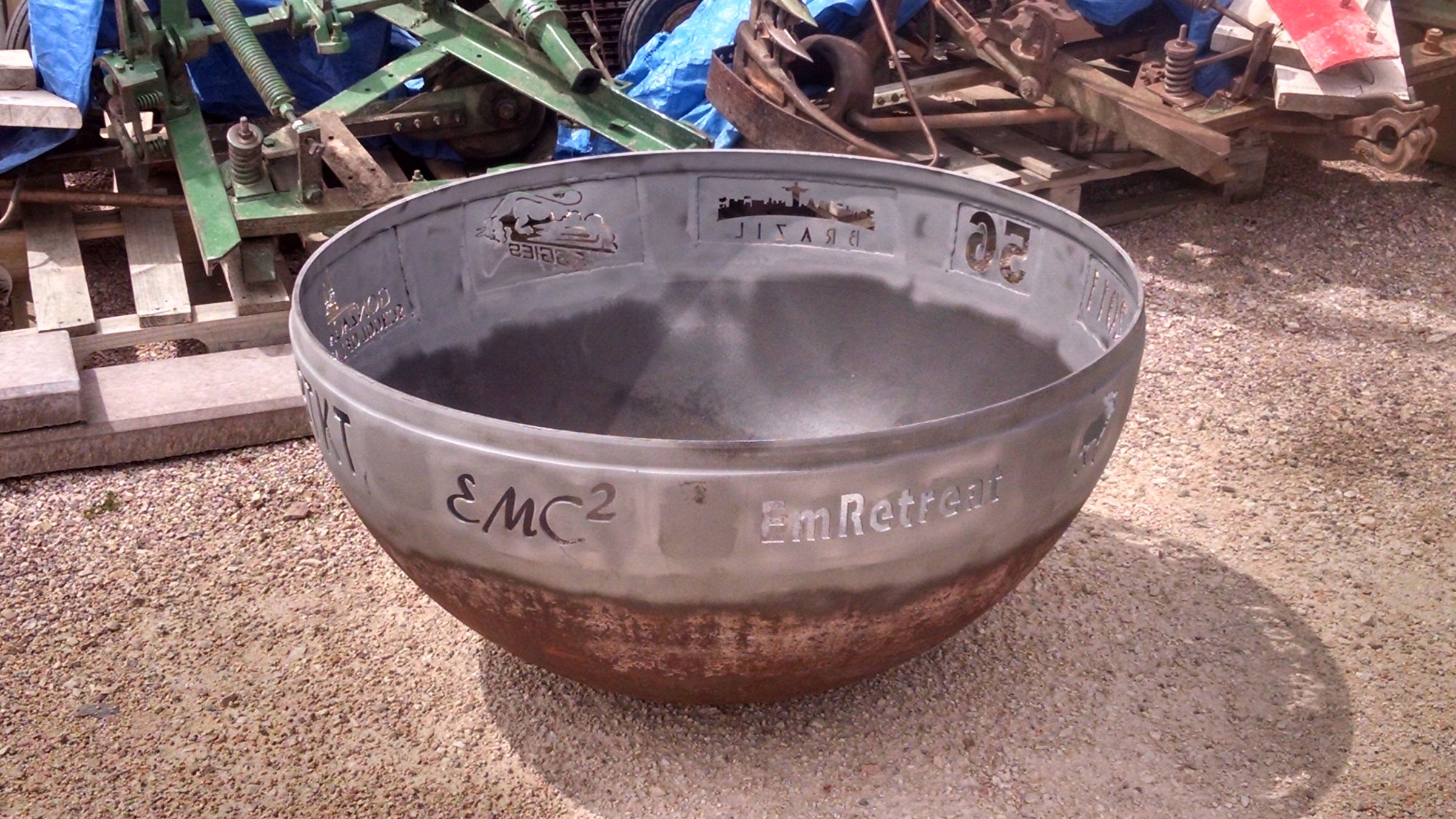

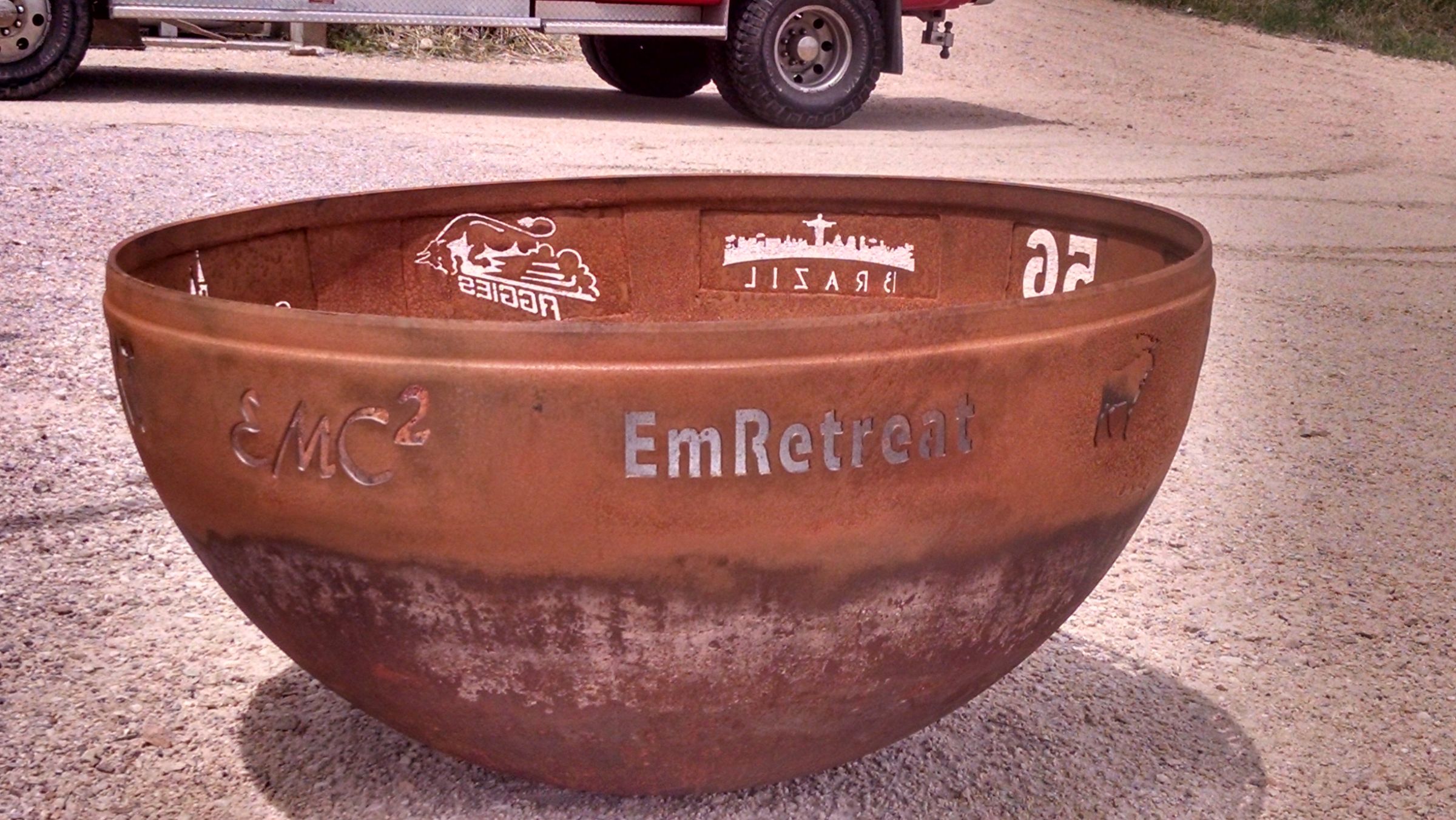

6 years ago

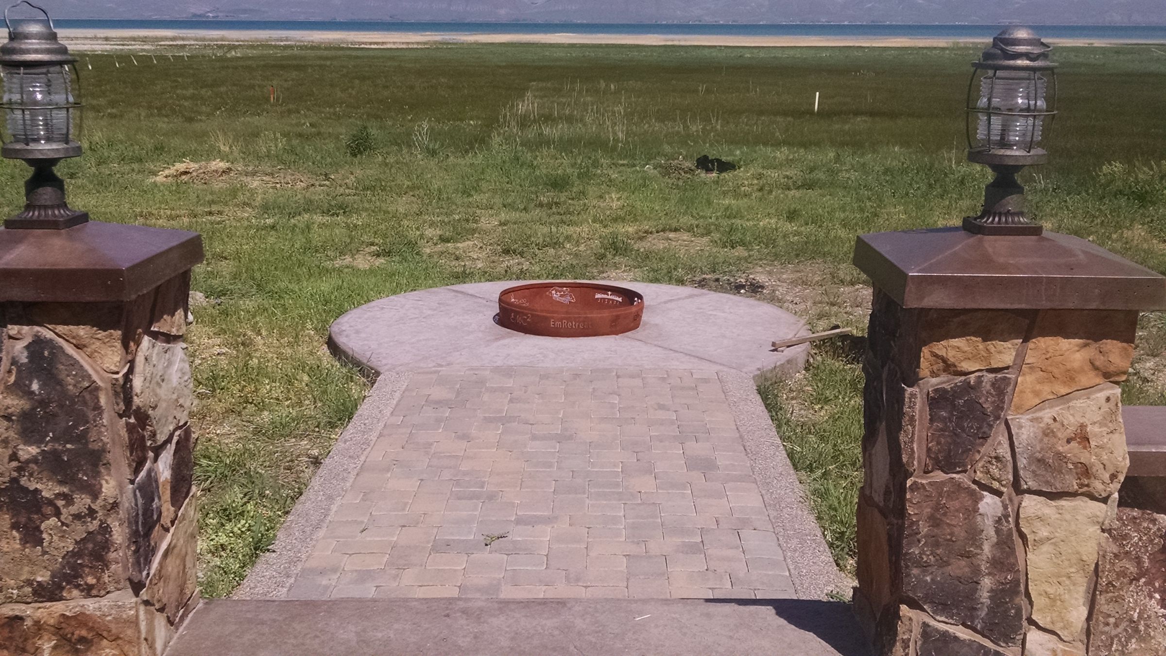

Hello, I am using this formula ( mostly, maybe a bit stronger H202) and am loving the results so far. Will post first photo and when done will post another. I started with a sandblasted fire pit and then added coats.
0
ezliving
ezliving
Reply 6 years ago
I have placed it and am hoping it will age gracefully, without being disturbed too much until it set's up. Will probably have a few camp fires in the meantime. Thanks for all of the great info that helped get me hear..
