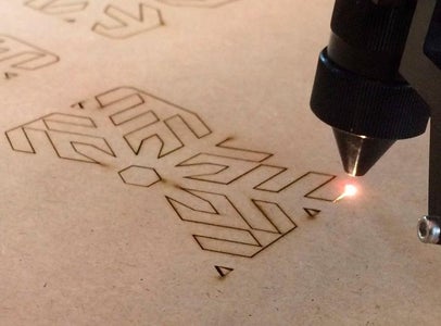

Step 4: Laser Cutting and 3D Printing
Every great catapult needs someplace to put the projectile, this is where 3D printing comes handy, by making a kind of bowl, with the exact measurements of a tennis ball (The projectile used in this specific case), and screwing it into our thrower.
Laser cutting was implemented in the design department, by developing some pieces with great exactitud, the physical structure of our catapult started looking much better, just by adding some plates of wood on the exterior of the chasis.

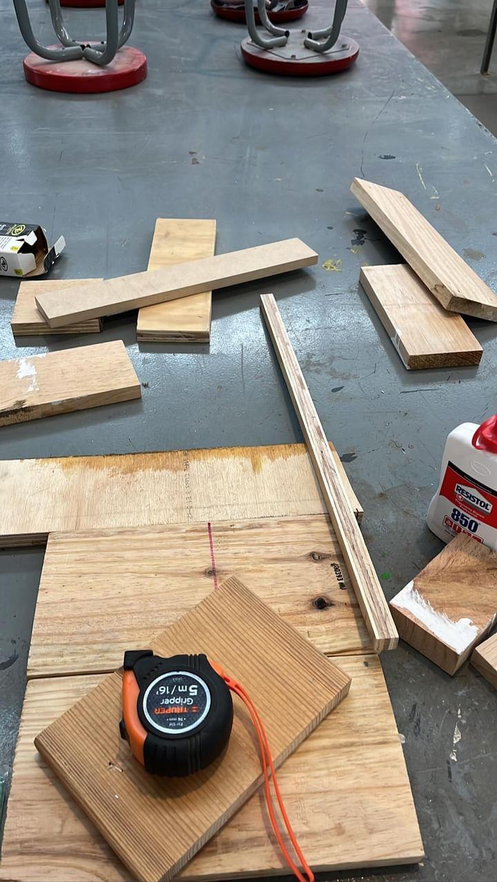

Step 5: Final Assembly

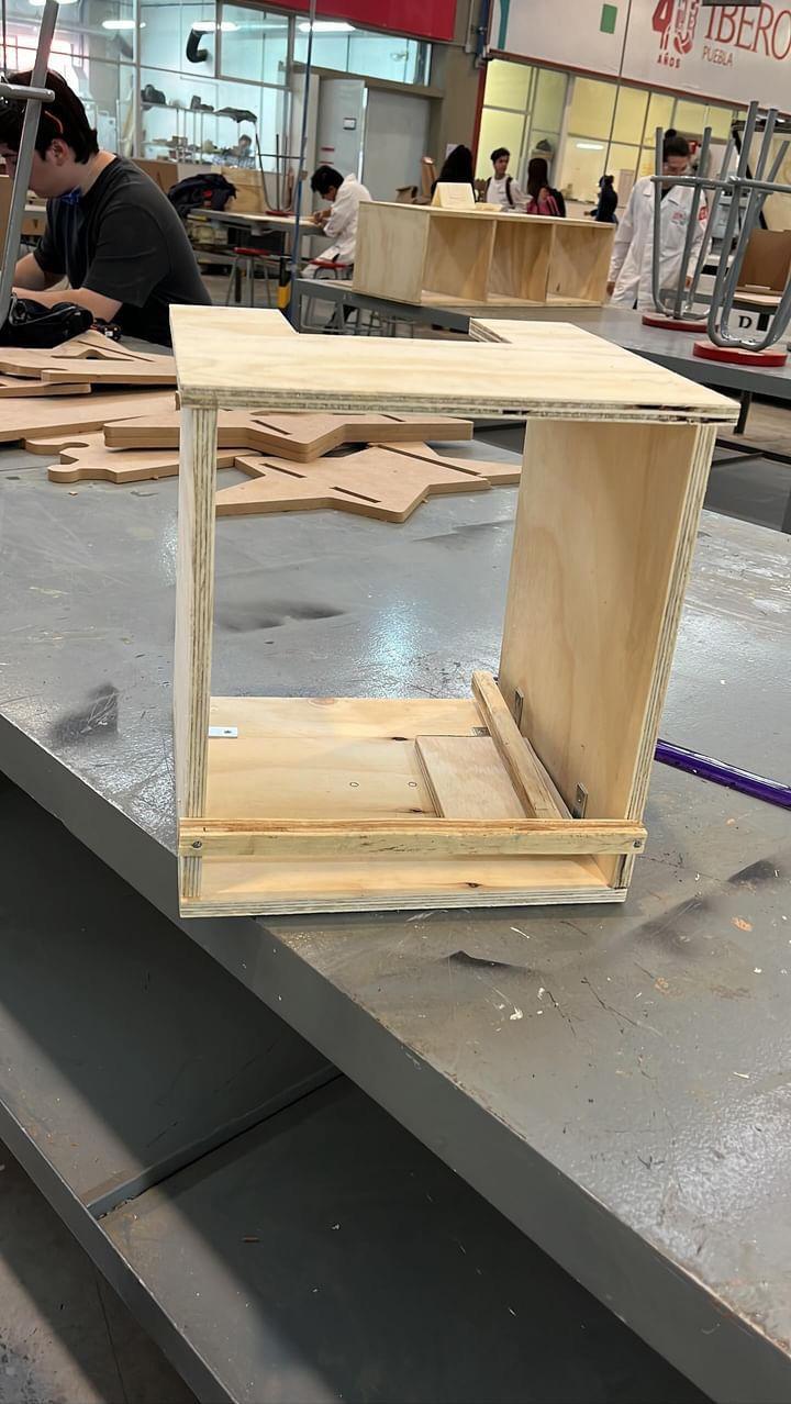

This is where everything comes together, to see if all the work payed off. By mounting a kind of "box" made out of 12mm wood, measuring 30x30x30cm , and adding a base of 50x30x10cm in order to have much better stability. After this and having all the exterior made, the mechanisms was based on a 4x50x4cm board of wood, 2 clams and the 3D bowl screwed into the opposite end of the board. So as to create tension to the board, an exercise tension band was tied up from end to end of the base with the board going in the middle. So as to when pulled down, the board would react by throwing an opposite force when released. Finally three eye bolts where used as a release lock, two in the base and one in the board, with the idea of connecting all three with a screwdriver and when wanted to throw, pull it out of all three, making it the release mechanism.
