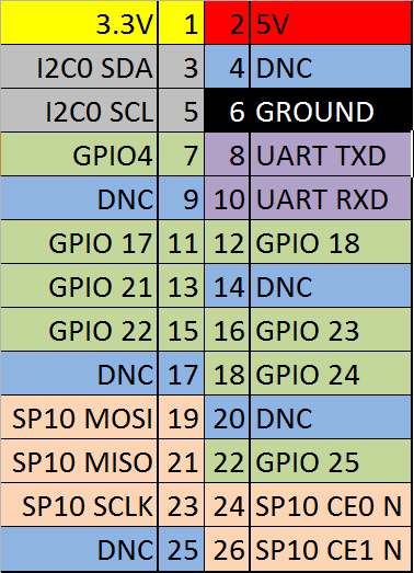

Step 2: Electrical Connections
Connect up the ATtiny85 to the Raspberry Pi GPIO (wire colours from the picture are given for reference):
GPIO pin ATtiny pin Comment
15            1                GPIO22 to Reset (through 1K, Blue wire)
17            8                3.3 V (Green wire)
19            5                MOSI (through 1K, Yellow wire)
21            6                MISO (through 1K, Orange wire)
23            7                SCLK (through 1K, Red wire)
25            4               GND (Brown wire)
