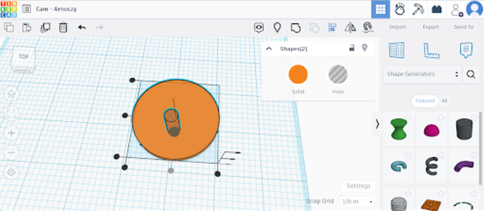

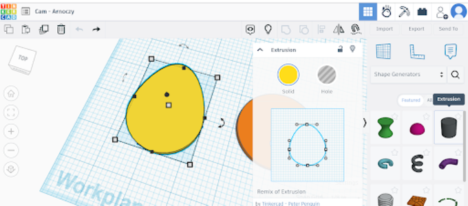

Step 1: CAD Practice
Computer-Aided Design (CAD) is an important skill all modern engineers must learn. On Wednesdays, my students use their warm-up time (the first 5 to 10 minutes of class) to practice Tinkercad (a free, browser-based CAD program).
In Tinkercad, I add all of my students into classes so that I can track their work. I also use the Tinkercad Activities to organize the different projects throughout the semester. Using the Activities, I can see each student's CAD specific to that one project.
In the weeks before this module, the students will complete the instructions in the Tinkercad - Make an Automata Cam document. They will design two simple cams - an eccentric cam and an egg shaped cam. The instructions break down the practice into 4 short chunks, each requiring about 3 minutes to do. In these chunks, the students practice adding simple shapes, changing sizes, aligning 2 or more components, solids and holes, grouping 2 or more components into a single unit, and custom extrusions.
As we progress into the semester, the students continue to practice their CAD skills with progressively harder exercises. I try to incorporate at least one project with a 3D printed component each semester.
I put the instructions into a quiz on Canvas and add a True / False question - "I completed week xx of the Tinkercad Cam design." This automates the grading of the warm-up. Every few weeks, I'll double check the Activity folder and make sure the students are completing the work properly.

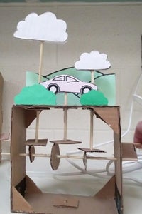

After a team has completed the Inventor Biography, they will spend three days building a basic automata box and exploring different mechanics involved and thinking about the scene they would like to create.
These instructions and photos are included in the Automata slides.
  1. Collect your materials
  2. Cut out 4 pieces of cardboard - 6” x 3”
  3. Poke a hole in the center of 3 pieces
  4. Glue them into a box
  5. Glue small triangles into the corner as braces
  6. Glue a small piece of cardboard under the top hole - this will reinforce your bearing and keep it from leaning
  7. Cut a 1.5” piece off of your straw and place it into the top hole - this is your bearing which allows the vertical rod to freely move up and down
  8. Cut one of your dowels down to 8”
  9. Glue a piece of cardboard (1” x 1.5”) and a 2.5" portion of the remaining piece of dowel to the 8” dowel - this is your axle and hand crank
  10. Cut the second dowel down to 6” - this is your vertical rod
  11. Place your vertical rod into the bearing and glue a small cardboard circle to the bottom (this is the follower)
  12. Place your axle through one of the side holes, add a cam, and then through the other side hole

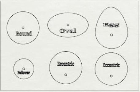

When they have the basic automata box built, the students are ready for the Mechanics Research Activity. I have several different styles of cams available for them to try in their automata. They need to test each out, describe what the resulting movement is, and think about how they could use this movement in their scene.
  • The Round cam, when placed slightly off-center, will turn the vertical rod in one direction.
  • The Eccentric cam is often used in pairs offset in opposite sides. This will cause the vertical rod to turn in one direction, and then in the other direction.
  • The Egg cam will keep the vertical rod low for most of the turn of the crank and then lift it briefly before slowly bringing it down again.
  • The Elliptical cam will raise and lower the vertical rod twice for each rotation of the crank.
  • The Snail cam will slowly raise the vertical rod, then drops it sharply.
I have attached the 3D files for these cams based on an 1/8" dowel for the axle. It's sized a little small, so you'll need to drill it out a little to fit your dowel / skewer. It's much better to be a little tight than too loose. If the cam spins on the axle, a small amount of hot glue on the cam and the axle will fix that. Not too much, or else the student will need to break the cam or the axle to change to the next.
If you don't have access to a 3D printer, you can print out paper copies of the "Automata Cams" file and have the students cut them out in cardboard. You'll want to remind the students to pay attention to how they cut out the cams - the smoother the cam, the smoother the mechanical movement.

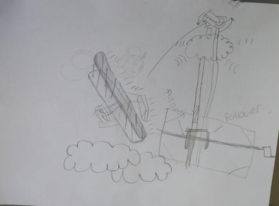

Step 5: Brainstorm & Design
When the team has completed the Mechanics Research Activity, they'll spend 15 minutes brainstorming different ideas for their scene.
Again, students like to rush through this phase because they want to get to the building portion. But creativity and brainstorming are vital engineering skills that take practice to develop. So I make them create at least 3 different ideas before I let them move on.
Once they have at least 3 different ideas for their automata scene, they choose one and draw out their design. The design must include a labeled diagram of their automata including the invention and scene it is depicting, at least 2 separate movements and the cams they are using to make these movements, and the foreground and background scenery.
I show the students some examples of designs. One is from Paul Spooner (a famous automata artist). Other examples are previous students' work to display features that make a high quality design.
When the students complete their design, I grade it using the Inventor Automata Design Rubric. Using the rubric, I can give them feedback on how their design meets the criteria. Students will have a chance to improve their design, as needed, based on the feedback.
I don't grade the rubrics on the first go round. If I give them the grade and the feedback at the same time, they often ignore the feedback and move on. But by giving them the feedback before grading, they have a chance to improve their design. And the more fleshed out the design, the easier the build goes.

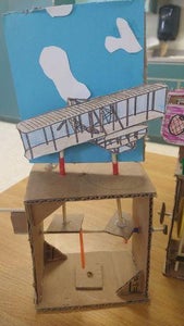

Step 6: Build
Now that they've gained a deep understanding of their chosen inventor and the mechanics of the automata, it's time to bring their project to life by building the scene. I give the students 4 or 5 days to build their scene and mechanical movements.
Ideally, the students will have done all the prep work necessary and building will go quickly and easily. I spend most of this time, walking around asking and answering questions to help them improve their build.
At the end of the build, the last thing the students will do is take a 1" x 1" piece of cardboard and glue it to the end of the dowel that makes the axle / crank. This keeps it from sliding back and forth and taking the cams out of alignment. If they glue this piece on before the end of the build, they won't be able to take the axle out and make modifications to the cams.
