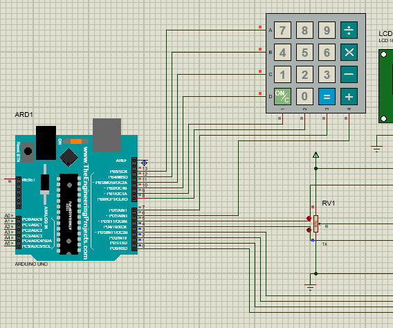

Step 1: Connect the Circuit.
Connect the circuit as per the circuit diagram.
Then upload the programmed .hex Arduino file into the Arduino component in the Proteus software.
click on this link for Arduino Program
And then run the program.
