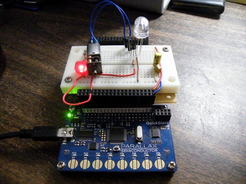

Introduction: Propeller Power for the Arduino
Drop a Parallax Propeller processor onto an Arduno board and what do you get?
Meet the ASC board - Arduino Shield Compatible Propeller board – from Martin Hodge.

The LCD Project:
This project adds a two-line LCD display to the ASC system.
Since the display is a receive only serial device only three wires are needed –
Power, ground, and Serial-TX.
The display runs on 5Vdc. Power and ground are connected to the POWER header.
Our serial port is created in software using a driver from the Propeller Object Exchange (OBEX)
called “FullDuplexSerial.spin”.
For this example the TX output is assigned to pin 23, which is brought out on the AUX header.
(see the board pin diagram).
Serial Driver:
In the example code note that the driver object is named in the OBJ section of the SPIN editor.
Note how the alias "LCD" is assigned to this object.
The TX pin is assigned the value of 23 in the CON section (Constants).
And the driver is started in the first line of Demo (the PUBlic method).
LCD.start(TxPin, TxPin, %1000, 9_600)
This invokes the start procedure in FullDuplexSerial object and passes the needed parameters
to the driver code. We assign pin 23 to both TX and RX, since the LCD display does not talk back,
and run the serial port at 9600 baud.
Our project code communicates with the serial driver via LCD.tx for text, or LCD.dec for decimal numbers.
LCD.bin and LCD.hex are also available. Read through the file FullDuplexSerial.spin for more details.
