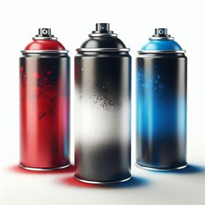

Step 6: Painting
Give everything a quick wipe-down with some acetone to make sure everything is clean before painting. Now spray paint the body with blue paint and the wings black. Make sure to follow the directions on the can and apply multiple coats of paint as required.
I installed the stainless steel rod at this stage since you need to mount the Pukeko on something to spray paint it anyway.
Mask out the Pukeko's body and then spray paint the beak red. Once the paint is dry remove the masking tape.

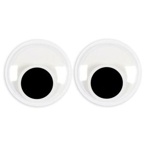

Now stick the googly eyes on the Pukeko, I probably should have used something nicer but I think the googly eyes are funny.

This project went well and I'm happy with the result, though I did make a mistake along the way and accidentally printed out the legs on a smaller scale, I've since fixed this on the template that is attached. In hindsight, I probably should have gone for some red reflective eyes rather than the googly eye. The short legs and funny eyes give this a sort of blue pigeon look, so I might change this later.
