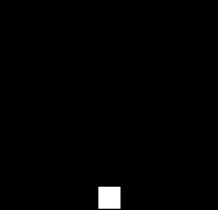

Introduction: Pygame Example
This is a pygame example.
Any computer that has pygame and python
text editer
and some way to run that code

This is a basic Pygame program that creates a simple game where the player can move left and right and jump. The player is affected by gravity and cannot jump while in the air. The game ends when the user closes the window.
