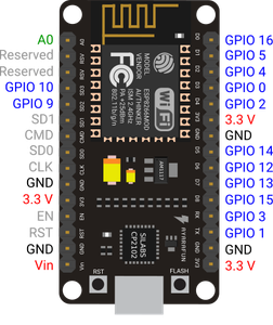

So I bought an Arduino ESP8266 (includes WiFi function), connected it to a 4 Channel 5V Relay Module, wrote a little webserver, attached it to my wife's wheelchair, and voila, she was able to control the wheelchair seat functions with her eyes.
Step 1: Assembling/Wiring Arduino, Power Supply, 4 Channel Relay Module
The Arduino and Relay Module operating voltage is 5V. Therefore the 5/3.3V Power Supply Module is required to provide the 5V. Luckily the trigger voltage for the Relay Module is 2.5 to 5V, therefore it works with the 3.3V IO ports of the Arduino. The Relay Module is required to decouple the 12V wheelchair voltage from the circuit.

const int GPIO_EYE_ENABLE = 12;
const int GPIO_MAIN_FUNCT = 13;
const int GPIO_SEAT_FUNCT = 4;
const int GPIO_SEAT_UPDWN = 5;
... these are the GPIO pins used for controling the relays.
