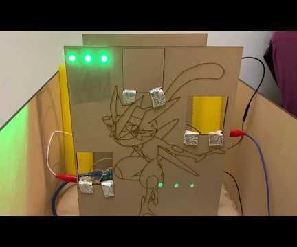

set your password
if you input the correct password the lock will open and green Led light will bright
if you input an incorrect password the lock will not open and red Led light will not bright
press * to delete your Input password press # input your password

Step 4: Step 4 : Assemble the Components
Use the type to place the item on the finishing box
Step 5: Step 5 : How to Use
Put things and turn the motor to lock
If you want to open, please press the correct password.
If you press the incorrect answer, the red LED will light up
