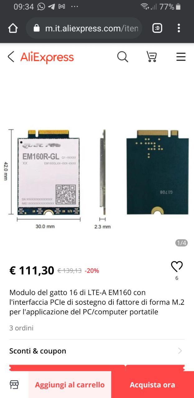

  • Quectel EM160G ES
  • M2 to MPCIE adapter

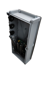

  • Waterproof enclosure
Luckily with version 7 of Router OS, Mikrotik supports Quectel modems by default without the need for any tweaks.
Step 1: RouterBoard Plate
I used an aluminum plate with the regular motherboard brass spacers to install the RouterBoard. I then also built a 90 degrees holder for the antennas, which in my case I chose to be isotropic: I'm just 1km from the BTS, so I don't need much gain, and fitting 4 directional antennas for the 4x4 MIMO would have been tougher.

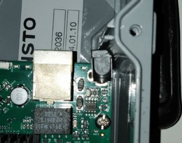

Step 2: Not Everything Went Smooth...
