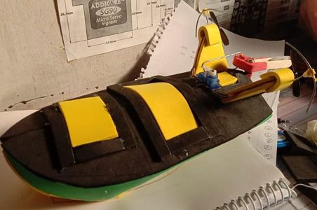

Step 5: Assembly
After testing the electronics I started making parts and changing a few dimensions to fit electronics inside the boat.
I used a cutter to make parts from foam sheets and assembled them using super-glue and waterproofing inside the boat at the bottom.
After assembling all parts I started installing electronics and motors and glued them inside the boat.
Step 6: Testing
The final test of all mechanisms using mobile.
Step 7: Final Run !!
Completing obstacles course.
Step 8: Conclusion
Controlling the boat was hard due to the low latency caused by the BlueTooth module.
No water got inside the boat and all mechanisms worked according to their purpose.
