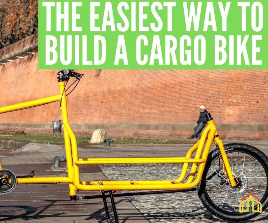

Step 2: Geometry
For the frame we have chosen stainless steel tubes ST37-3 with a constant thickness of 1.5mm. With these tubes it's possible to obtain a really good stiffness of the frame while keeping the weight low. For the head tubes, the choice is connected to the headset that will be used. We have opted for a 1" 1/8 threadless headset, EC34, which requires a tube with an internal diameter of 34mm. Our selection is Dedacciai 34x1.
Before discussing the practical realization, it's important to focus on some design aspects.
Length of the loading bed
The length of the loading bed depends mainly on the needs of the final user. A long surface will offer more loading capacity, at the cost of a heavier and less agile bike. Viceversa a short surface will result in a more responsive bike (especially in some situations like u-turns). We have chosen a short length of 520 mm, suitable for carrying kids and an average amount of goods. This feature is especially good on the narrow italian cycling paths, where zig-zag between obstacles is a never-ending story.
Width of the loading bed
Generally this value is kept lower than the length of the handlebar (max 600mm). In this way is simpler for the driver to understand where is possible to pass through and where not. We have therefore chosen a value of 530 mm, realized using three equally spaced tubes.
Front steering angles
The fundamental parameter of interest is the fork trail. Generally, the trail varies between 50 mm to 63 mm. A high trail value will result in a stabler bike at high speed, less agile at lower speed. We have chosen an intermediate value of 57 mm. At this point knowing the fork rake and the front wheel diameter (20"), it's possible to decide the head angle to obtain the desired trail.
For the trail calculation you can either use a 2D CAD (many freeware available) or an online calculator like Bycicle Trail Calculator. The final design of the bike is reported in the pictures.

Step 6: Steering and Kickstand
The last part of the project is represented by the kickstand and steering rod.
The steering rod transmits the rotation impressed on the handlebar to the front wheel. Among the various systems we have chosen the single rigid arm. The choice is dictated mainly by the simplicity of the system and by its small footprint.
The main charateristichs that the single arm system needs to have are:
- Stiffness, to avoid whobbling effects of the front wheel
- Simmetry, in order for the bike to behave the same in left and right turns
To obtain the right stiffness we decided to use a quite beefy circular profile (16x1.5mm), while for the simmetry requirement we operated on the geometry directly in the CAD.
The last design parameter is represented by the ratio between the angle of the handlebar and the corresponding steering angle of the front wheel. From experience we have found that a ratio slightly higher then 1 makes the steering more responsive.
With this solution we were also able to limit the maximum handlebar angle, so that during a tight turn the outer hand doesn't need to move too forward with the risk of losing balance.The optimal ratio that we've found was 1.2, as showed in the picture (wheel angle of 40° obtained for steering angle of 33°).
Once the shape of the rod is decided, it's time to choose where to place the mounting bracket on the fork. To determine this parameter we can place the front wheel all turned to the left, placing the bracket so to have a minimum space between the rod and the wheel.
To fix the rod we used an M8 female joint head. To secure them to the rod we took advantage of the geometry of a hexagonal cap screw M8, the diameter of itd head being exactly 13mm. It fits perfectly inside the tube and it is easy to weld.
The last part of the build regards the kick-stand. Unfortunately this small component it's actually one of the trickiest!
Our kick-stand moves rotating on two pivots grafted on two bushings welded to the frame, and when it is in its parking mode is positioned with an inclination of about 5 ° to the ground. This angle is sufficient to ensure a stable stop, and prevents the center of gravity of the bicycle to move too far forward. By using a higher angle you'll risk that the kick-stand gets stuck when pushing the bike front, making it difficult to use.
The other kick-stand feature is the length of the leg, that we have designed so as to lift the front wheel off the ground of about 20-30mm. It is a fair compromise, allowing a good stop over rough terrain or slightly downhill, while avoiding to lift the bike too much, making a stop very tiring especially with front load.
At this point our frame is complete, ready to be assembled with all the components.
