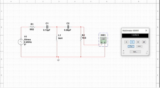

Step 2: Simulating Impedance Matching Circuit Using Multisim Software
The next step is to simulate Impedance matching circuit.
Impedance matching is necessary for maximum power transfer between Antenna and RF-DC converter. This circuit is employed in this project to have minimum return loss and to improve the performance of the system.
We have chosen T-match network because of its high Q and low ripple factor characteristics.
T match circuit is designed and simulated using multisim software as shown in the schematic above.
The output from this circuit is noted and compared with the practical ouptut.

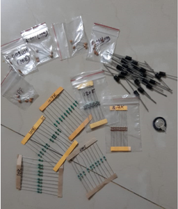

Step 4: Gathering Components
After designing all the three blocks of the circuit i.e., Antenna, impedance matching circuit and RF to DC converter, the components as per design are gathered.
The required components as per schematic that we have designed here are:-
  1. HSMS 2860 Schottky diode
  2. Double layered copper clad board
  3. PCB mount SMA connector
  4. Coaxial cable (impedance 50 ohms)
  5. Resistors - 47 , 1K, 10K ohms
  6. Capacitors - 1pF, 1nF
  7. Inductor - 10nH
  8. Wires and jumper cables
  9. Super capacitor
  10. LED
Note: Sometimes you don't get the components of exact values. So, the alternative is to get the components of approximate values.

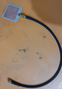

Step 5: Fabricating Antenna
When you are ready with the schematic and required components the next step is to fabricate them according to the design.
  1. Firstly, fabricate the antenna either by chemical etching or milling process. We have fabricated antenna using chemical etching process.
  2. Next, place and solder the SMA connector correctly onto the antenna feed.
  3. Then, connect the coaxial cable of impedance 50 ohms to the antenna just as shown in the above image.

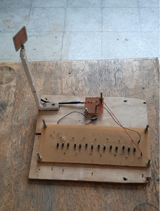

Step 7: Testing
Now, it's time for testing the circuit.
As observed on the oscilloscope, the final output i.e., the RMS value that we have achieved is in milli-volts which is approximately equal to the values obtained from simulation.
I would like to mention that the output that we get here is not constant as it completely depends on RF energy. You may get in millivolts or sometimes in volts depending on the intensity of RF energy waves.
The output DC voltage can be amplified by adding more number of voltage doubler circuit stages to the RF to DC converter.
Note: We obtained this output when the circuit was placed near a couple of cell phones.
Step 8: Testing With Super Capacitor As Load
A super capacitor is connected across the output terminals of this circuit and is left to charge for some time. After a few hours of charging of capacitor the charge across the capacitor is measured using a digital multimeter as shown in the image.
This prototype is feasible only for low voltage applications and further can be connected to DC voltage booster for other applications.
