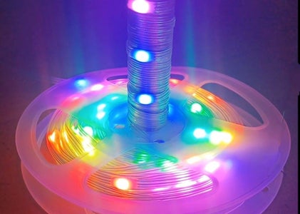

Step 1: What We Will Build
Here are the parts for the project and what they do:
1.The baseplate, which the excess RGB string will be wrapped around and then go to the powerplug
2.The top magnet
3.The RGB LED string
4.The Bottom magnet attached to a string so that the magnet cannot go too close and stick to the top magnet. The string will act like a leash for a dog so that the dog cannot run to the other dog (the top magnet)
5.The two forces of the magnets will be strong enough so that the bottom magnet will not fall to the ground and the string will not let the two magnets touch each other so that the magnet will float.

Step 4: String It
Carefully remove the model from the baseplate of the 3D printer when the model is done. After that, find the point of the RGB strip (you can easily buy one at a Cina shop for 14 Dollar) and wrap it tightly from the top to the bottom as shown in the picture above. You can use some clear glue if the end point of the RGB strip gets loose.
Step 5: Stick It
Stick the 3D printed part to the middle of the the spool as shown above and wrap the excess string around the spool, but don't wrap all of the RGB string around it because there must still be enough string left to go to the power plug.
Step 6: Magnet It
Now we have to use the magnets to make an illusion. Take one of the small magnets and stick it with glue against the top bar as shown in the pictures above.Take the second magnet and stick it to a piece of string (preferably thin string like thread, because it is not very visible). Stick the string to the base, but you have to do it precisely because if the string is too short, the force that keeps the two magnets together will be too weak and the magnet will fall like a meteor hitting the earth, but if the string is too long the magnet will stick to the top bar.
