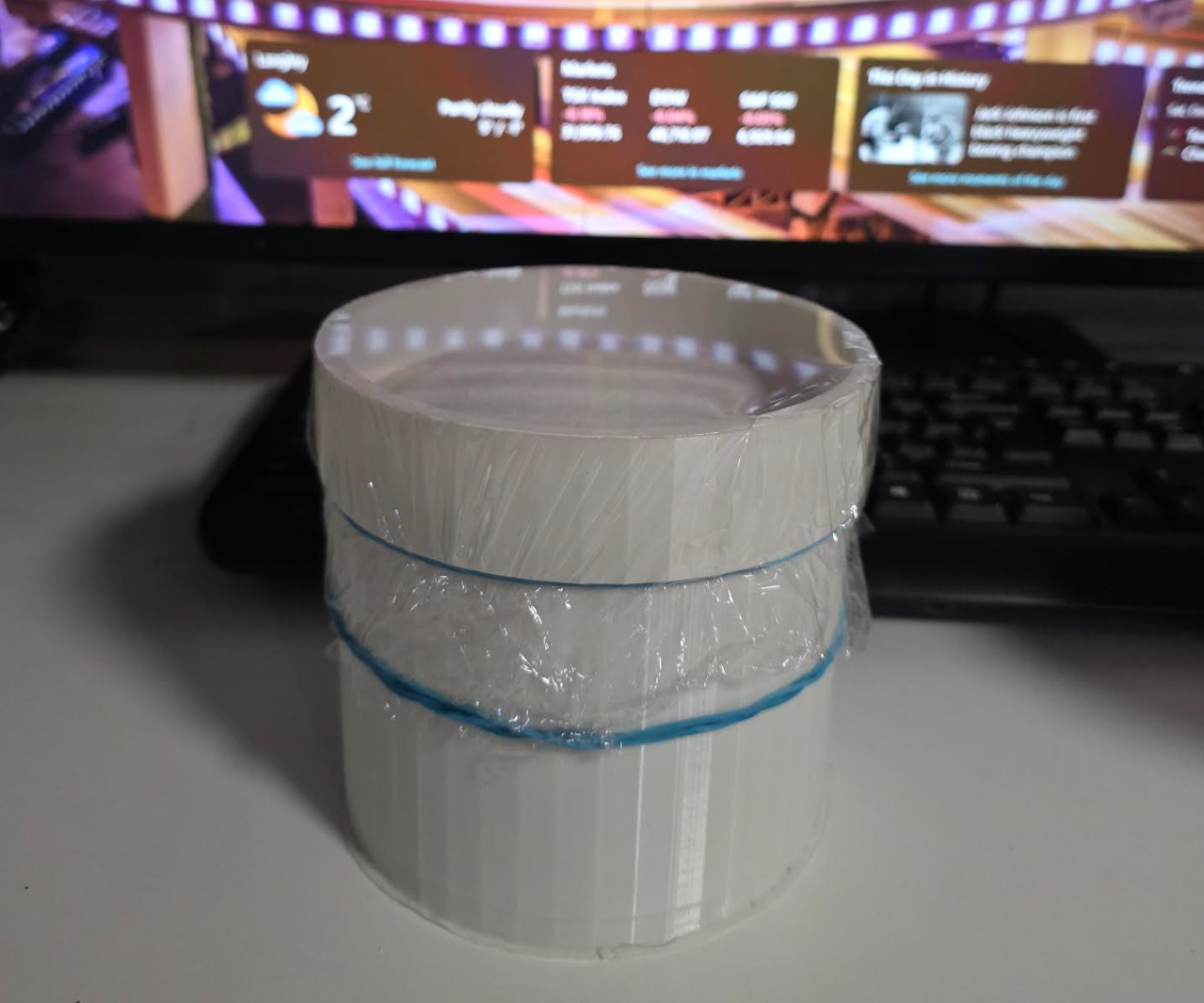

Step 16: Put Board and Microbit and Battery in Box
Ensure that everything beneath the lid is placed inside the box. Create space to accommodate a battery, then insert the battery into the designated area.
Step 17: Connect to Battery
Lastly, connect a wire from the Microbit to the battery and then securely close the box.
Step 18: Prank Your Friends
Position this on a desk, and when someone walks past, a rubber band will fling at them. I hope you had fun making this with me.
