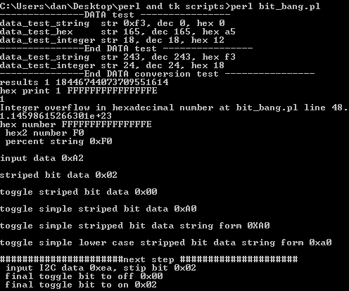

Step 5: Set Up Your Perl Script
There isn't a lot to this step, the permission work is all handled with the rest of the files. you can use any Perl script to for this part. Here is one that uses the I2C ports for an example. You can place any executable script here. Make sure to check the permissions as shown in the picture. Also this setup requires the script to be located in the following path /home/pi/one_button/sprinkler. See the screen capture attached
