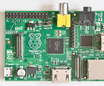

1) Locate either a PC or Raspberry pi for the main controller

1) Install Perl on your computer, Google will give you many examples on how to do this. If you are using the raspberry PI for this, it will already have Perl, but you will have to add the TK extension. You may also have to add the IO ::Socket module. There are may places on the internet that can help you with this step
