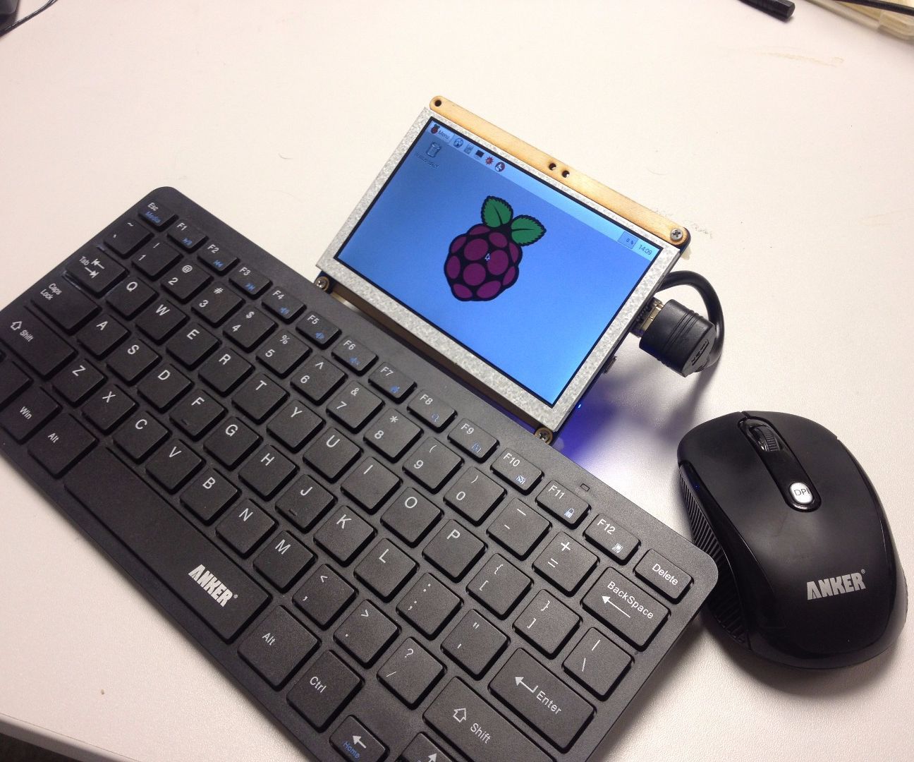

Step 2: Setting Up the SD Card
The SD card should contain the latest version of Raspbian, available for download from the Raspberry Pi Website.
Download the image and burn it onto your blank SD card using your preferred method. You then need to install the drivers for the TFT screen. The best method is to run the DIY installer script, explained on the Adafruit page. At this stage I would recommend testing that the everything is working properly, so connect the screen to the Raspberry Pi, attach the PiJuice with a charged battery and switch it on. If everything has gone to plan your screen should be showing the normal boot up messages. Hooray!
Step 3: Setting Up the Camera Module
Inset the the camera's ribbon cable into the Raspberry Pi. The connection point is located between the audio and HDMI ports. Make sure that the blue side is facing away from the HDMI port.
Now is a good time to check that the camera is working. First it needs to be enabled so go to the terminal and type "sudo raspi-config" and follow the menu to enable the camera after which the Raspberry Pi must be rebooted. After reboot the camera should be working properly. Go to the terminal and type the following command. "raspistill -o pic.jpg" This will make the camera take a picture with the title pic and save it in the /home/pi directory.
