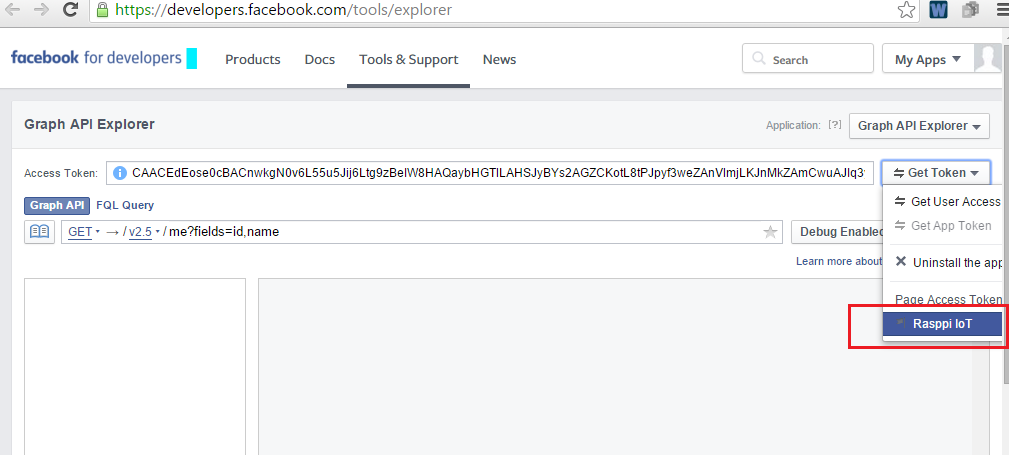

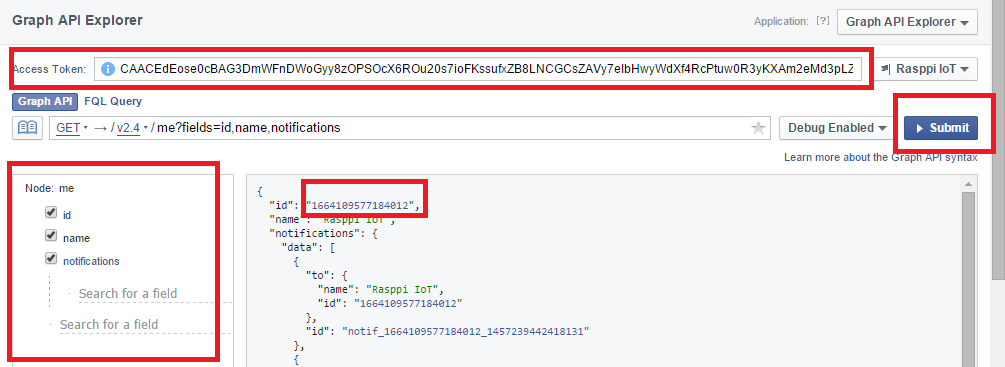

We will access our Facebook account using Facebook Graph API. Most request of Graph API need an access token as a parameter. An access token is unique to the combination of a logged in user or page and the Facebook App that makes the request. A token is associated with a Facebook app to handle the permissions that the user has granted to the app.
To get Access Token follow the steps:
1. Go to https://developers.facebook.com/tools/explorer
2. Click the button on the right to Get Token Drop Down came down to it.
3. Choose to Page Access Token
4. Select necessary field from the left side and click Submit.
5. Copy Access Token & id. We will use it to our program.
OK, we got the Access Token.

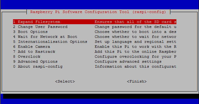

We have completed connection. Now, lets enable SPI interface of Raspberry Pi. To do this,
1. Open terminal and type:
sudo raspi-config
A configuration window will appear like below.

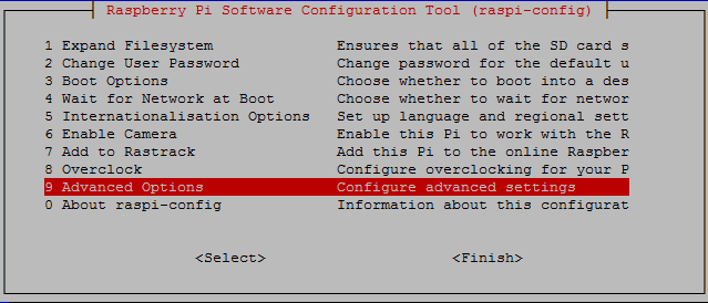

2. Press down arrow key and select Advanced Options & click Enter.

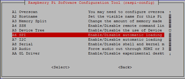

3. Select SPI and click Enter
4. It will ask for confirmation, just press Enter to yes.
5. After confirming a new window will appear asking you like to load kernel default or not. Select yes.
5. You may ask to restart your Pi. Restart it. Now your SPI interface is enable.
