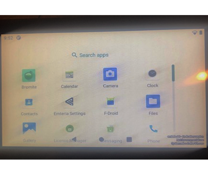

Okay, now that you are done with making the phone, on your computer go to poptox.com. Look at the top of the page and click the Plans button. Get the basic plan when you know your phone is working. Test calling your your phone or other phones. It will not work if you are calling from your phone. So this version does not have everything a phone does, but in another instructable I tell you how to make a phone that runs on a android type operating system and is amazing! This is my first version and is obviosly not the best, but it still works! Open your phone and go into google, type poptox.com, and login. Bookmark it and save the link so all you need to do is press the button and you can go to the site.
