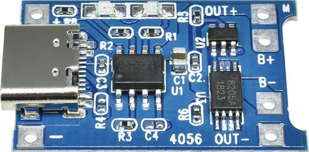

Battery Charging Board: This is to charge the battery for the iPad.
https://www.amazon.com/gp/product/B091N5L7J2/ref=ppx_yo_dt_b_search_asin_title?ie=UTF8&psc=1

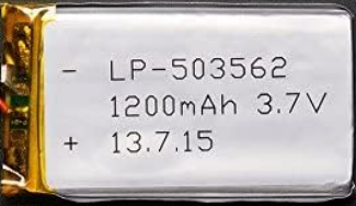

3.7 volt 1200mAh battery: This battery is a long lasting battery by Adafruit.
https://www.amazon.com/gp/product/B00J2QET64/ref=ppx_yo_dt_b_search_asin_title?ie=UTF8&psc=1

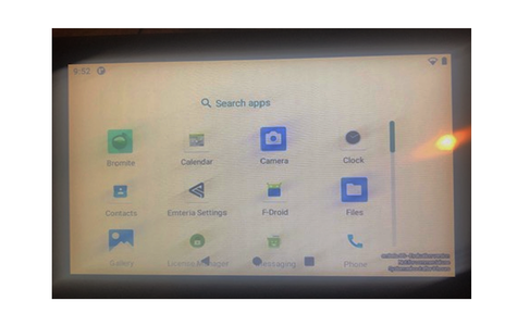

This step is pretty straight forward. Dowload the Raspberry Pi imager, which you can find here: https://www.raspberrypi.com/software/. After you set it up, click the button that says Raspberry Pi Device, and select Raspberry Pi 4. On your browser look up kongstakang or search this link:https://konstakang.com/devices/rpi4/LineageOS19/ Scroll down to where it says lineage-19.1-20230313-UNOFFICIAL-KonstaKANG-rpi4.zip. Down load it, and take out the file in it. Insert your SD into your comupter, and click the button on the Raspberry Pi Imager that says Operating System. Scroll down and select the button that says Custom Image. Then choose the Android file you just downloaded. Click the Write button, and then after it is done take out your SD card.

Okay, so now comes the hard part. If you have never soldered before, I reccomend that you watch this instruction video (https://www.youtube.com/watch?v=Qps9woUGkvI&t=42s). Soldering is very dangourous so I reccomend that you be very careful with your soldering iron. First solder the positve wire of the battery (red) to where the board says b+. That means battery positive. I will add a picture above. After you solder that, solder the battery wire negative (black) to where the board says b-. Take a wire and solder one side of it to one of the positive of the switch. Take another and solder it to the negative of the switch. Solder the one that is negative to where the board says out-. Now take another wire and solder it to where the board says out+. Now heres the tricky part. Take your Raspberry Pi and flip it over. You need to solder one wire from the Raspberry Pi to the board, then another from the Raspberry Pi to the switch to complete the circuit. Look up Raspberry Pi pinout and that will help you. Solder the board wire (out+) to the 5v pin on the Raspberry Pi. Be careful, because if you connect two pins your Raspberry Pi could break. Now solder the wire on the switch to the gnd (ground) pin on the Raspberry Pi. If your battery is charged, and you did everything correctly, then when you flip the switch the lights on the Raspberry Pi should light up.

Step 4: Setting Up Lineage

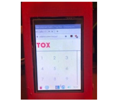

When you first boot lineage, it should make you set it up. Setup the time, wifi, and you should put in a passcode. After that you should boot up lineage. It looks like a regular Android setup. Go to the browser and look up these two apps, Dingtone and Aptoide. These are calling and app dowloading softwares. Find an apk for each of these apps. APKs are a way to download an app on an Android but using the web. Download them, and open both of the apps. You should make an account and pick a number on dingtone, and you just should look at Aptoide. Lineage has apps preinstalled, similair to an iPhone, but does not have any personal apps. Download the apps you want with Aptoide. Continue to costumize it. You should try running it with the battery instead of the plug now.

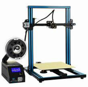

Step 5: Case
There is a case made for the Raspberry Pi 7 inch screen and the Raspberry Pi 4, and you can find here. You have to have acsess to a 3d printer though. I hope this iPad works for you, and thank you for building this!
https://www.thingiverse.com/thing:1082431
