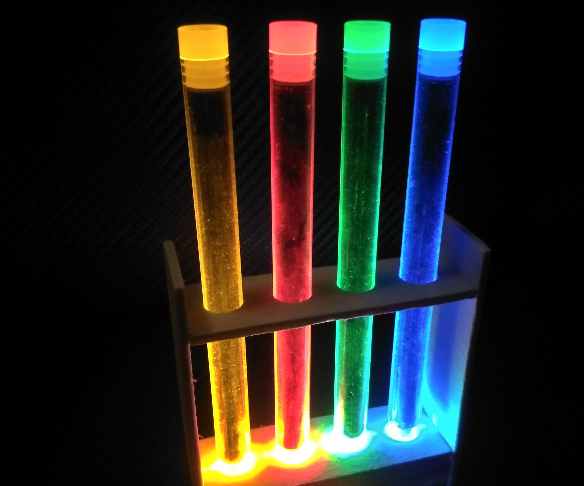

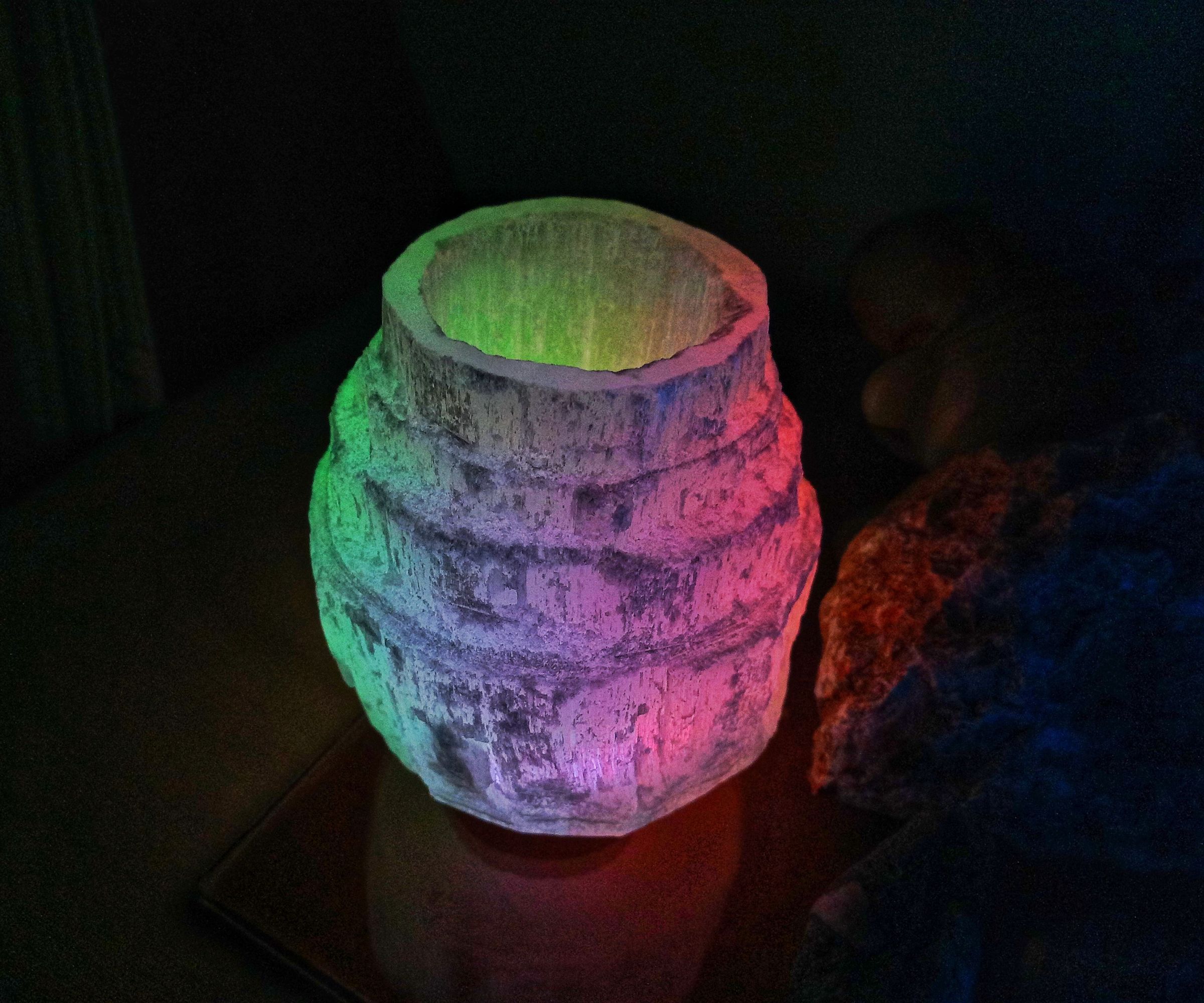

Step 14: Some My Other Documented Lights
just for inspiration
(click for more images there are step by step photos)
