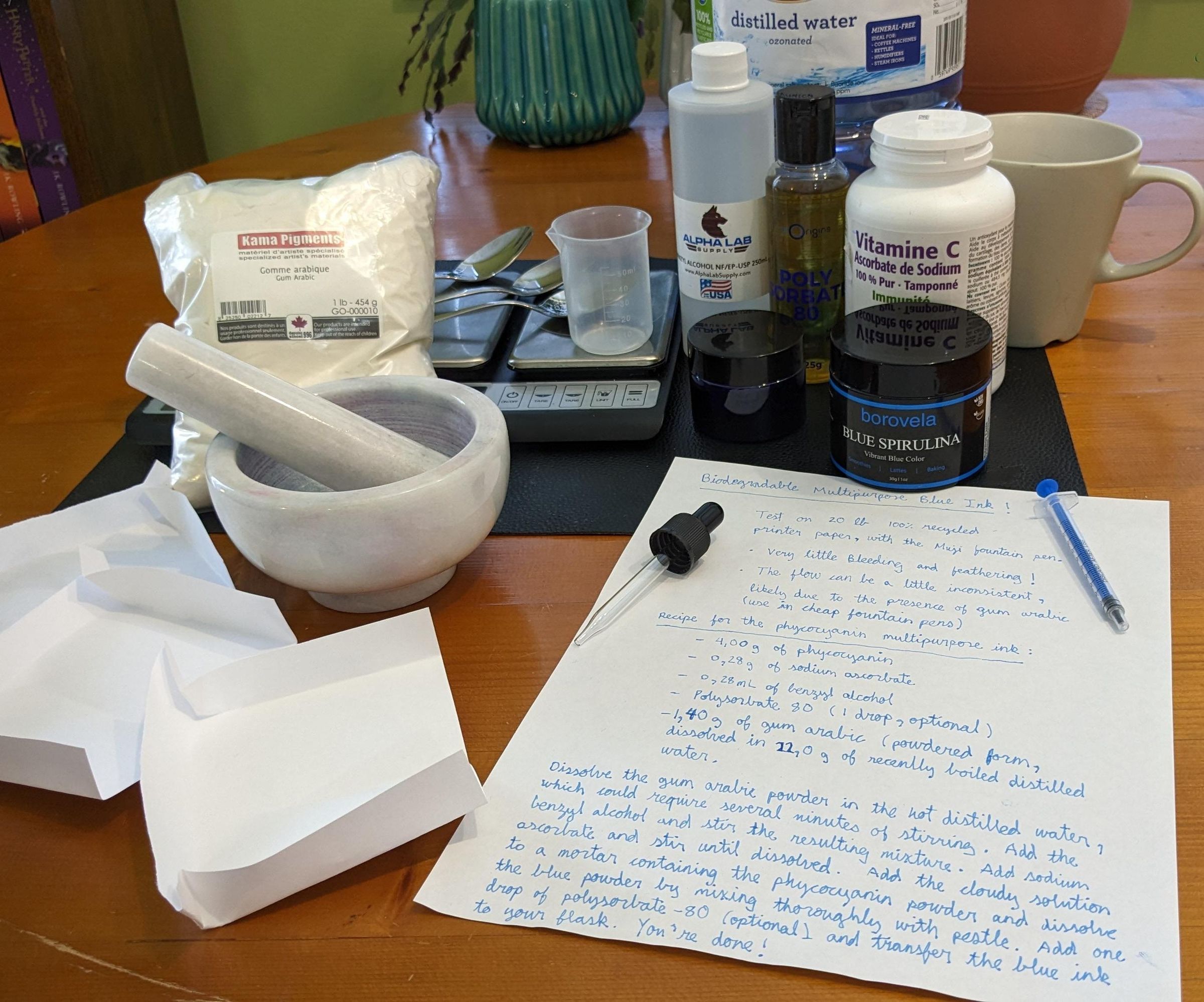

I did a stability test, and the ink formulation with 32 weight percent of glycerine was stable for up to a year at ambient temperature (20-28 degrees Celsius, see the photo above and the PDF report below). As a note of caution, please keep in mind that this ink is not of archival quality and should therefore not be used for official purposes.
Equipment:
- A centigram scale (0.01 g), two spoons and two weighing papers for weighing out the sodium ascorbate and phycocyanin.
- Two small plastic container for weighing out the distilled water and glycerine. They need to be light enough to use on your scale, yet able to contain around 30 mL (or 1 fl. oz.) just to be on the safe side.
- An eyedropper pipette for weighing out the appropriate amount of distilled water.
- A 1 mL syringe (without the needle) to measure out and dispense the benzyl alcohol preservative.
- A blue or amber glass jar to pour your ink into, the color of the vial will shield the ink from light, as phycocyanin is somewhat light-sensitive.
Materials:
- 14.48 g of distilled or deionized water (solvent, the ink is water-based and using distilled or deionized water will help prolong the ink’s shelf-life)
- 8.96 g of glycerine (32% wt/wt of glycerine is used as a humectant and thickening agent to give the ink a slicker feel. It also stabilizes the blue color in the ink, giving it a longer shelf life)
- 0.28 mL of benzyl alcohol (preservative, mould inhibitor used at around 1 % wt/wt concentration in the final mixture)
- 0.28 g of sodium ascorbate (sodium salt of vitamin C, used as an antioxidant at a concentration of around 1% wt/wt to stabilize the phycocyanin blue pigment towards light and oxidation)
- 4.00 g of phycocyanin powder (Also known as blue spirulina extract, a blue-colored protein that acts as the dye for this ink)
- 1 drop of polysorbate 80 (Also known as Tween 80, a non-ionic surfactant that will reduce the surface tension of the aqueous ink, thereby improving its flow properties)
