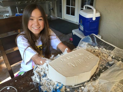

So, we need some kid-sized hands for the costume. Fake adult hands will ruin the illusion so we decided to make our own. Here's a warning and it is IMPORTANT! DO NOT DO WHAT WE DID. LEARN FROM OUR MISTAKE! If you are going to make replica body parts of any sort, make sure you use alginate or comparable impression material. In our haste, we figured it would be fine to make our mold from Plaster of Paris since it would just be her hands.. DO NOT DO THIS. Plaster warms up and can actually burn your skin if you use it improperly. Additionally, if it creates an undercut, you could become locked in the mold. Some of the plaster got underneath my daughter's hands which were supposed to be flat on the table. I had to chip her out with a wooden spoon. Luckily she was okay and the mold was still usable but she was not happy... Needless to say, I will not cut corners like this is the future.
