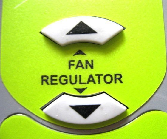

it is uses a common usb kit remote found in electronics store,
but you can modify the given code in order to use another remote,
