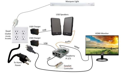

Step 4: Electronics Assembly
The final step is to cable all of the components. You'll need to connect everything to power and then cable the Raspberry Pi to the monitor. This is just the general way to cable the arcade using the standard items. If you are using a custom option (such as amplified speakers, volume controls, etc.) you'll need to follow those instructions separately.
  • Electrical
  • Marquee LED light to the outlet (optional)
  • Speakers to the USB charger, a USB charger into outlet
  • Monitor to outlet
  • Raspberry Pi to a USB charger, USB charger to an outlet
  • Low Voltage
  • Speaker 3.5mm jack to Raspberry Pi 3.5 mm out
  • Monitor HDMI to Raspberry Pi HDMI out
  • Makey Makey
  • Atari Controller with daughterboard
