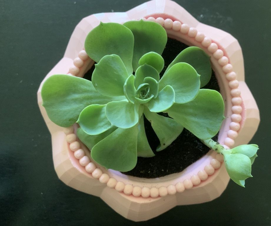

Printing:
I printed the smallest and the second smallest object for demonstration. The bed leveling test took sometime and resulting printing is good after some adjustment.
