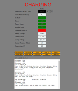

Step 6: Web Page
You will have to alter the SSID and Password in the NodeMCU(s) for your router to enable the web page and the Sender UDP. It is also best to set up your router up so the Mac addresses are associated with a fixed ip address. You will then be able to use your local browser to see what Robo Grazer is doing.
The web displays the rules as they execute and a full status of the Flags indicating the status of the system. Any errors detected are displayed as ERR XX. The format works well on your mobile display. Will need to ensure the working area has a WiFi signal.
