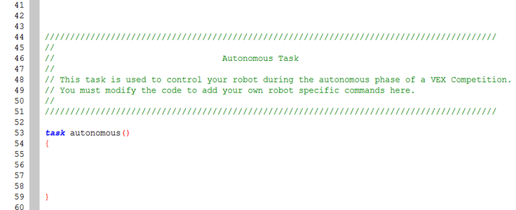

Autonomous:
This section of the Competition Template, is where you put your program-controlled drive, for the beginning of every match, otherwise known as the "Autonomous". In this code, everything that you want the robot to do MUST be controlled by your program, as trying to implement a drive program WILL NOT work in the Autonomous section of a competition.
Driver control:
Within the "while" loop, this is where you program your driver control. If you want a joystick to move the robot forward, while the other joystick turns it, this is where you would program it! In this mode, if you try to program an Autonomous to be triggered when you push a button, it can be done, however it is more advanced and can be quite difficult to operate.

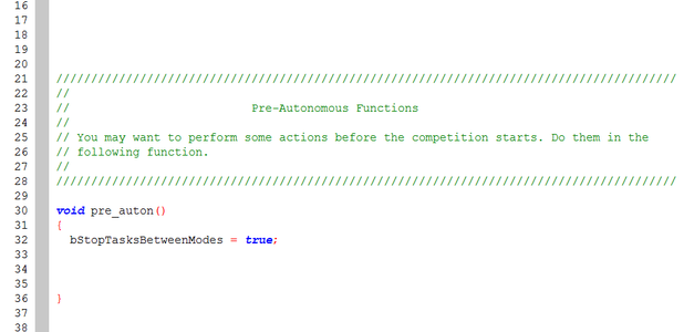

Step 5: Setting Up Your Pre-Autonomous
*Click image to enlarge*
Configuring/Resetting Sensors:
When programming an autonomous, you want it to be as accurate as possible, and to do so, adding a couple sensors will help A LOT! Programming these sensors can be difficult, but setting them up, is extremely simple! Once you have setup your sensor in the Motor and Sensor Setup, there is not much you have to do to configure them:
Setting up a gyroscope:
1. Make sure what you are going to type is in the Pre-Autonomous loop
3. Type the following:
SensorValue[] = SensorNone;
Add the name of your gyroscope between the "[]". Do not forget the semicolon!
4. Type the following:
SensorValue[] = SensorGyro;
5. Type the following:
SensorValue[] = 0;
In these 3 lines of code, "SensorValue", is the way of telling the sensor what you want the value to be. Setting the sensor as "sensorNone" tells the cortex that the sensor is non-existent, then telling it that the sensor is "sensorGyro", tells the cortex that the sensor is actually a gyroscope. This has just reset the gyroscope! When you are setting the sensor as "0", you are telling the gyroscope that the current degree is "0", so when you want it to turn 90 degrees, the value is exact.

Step 8: Writing an Autonomous
You have made it to one of the most difficult parts in this Instructable, writing the autonomous. Before even starting an autonomous, be sure that all of your motors and sensors are connected, and setup properly in the code. If you are writing an autonomous for a competition, I would highly recommend taking a birds-eye view picture of the field, and sketching out the path that you want the robot to take.
For this autonomous, we are going to stick with a very simple code, however everything you learn here can be used to a make very complex and high-scoring autonomous!
Programming a simple autonomous:
Let's say that I want the robot to drive forward, turn 90 degrees clockwise, lift up the lift, and then drive backwards, this can be easily done with the functions you have made!
standardMove(200, 80);  // Call the move function, forward for 2 milliseconds at speed 80
standardTurn(900);  // Call the turn function, turn 900, or 90 degrees. If you wanted to turn 45 degrees, you would enter 450
standardLift(500, 127);  // Lift the lift at full power, for 5 milliseconds
standardMove(300, -80);  // Move backwards for 3 milliseconds, at speed 80, or -80 in this case
That's it, see how useful those functions can be, it turns several dozen lines of code into only four! Without autonomous functions, that code would look something more like this....
