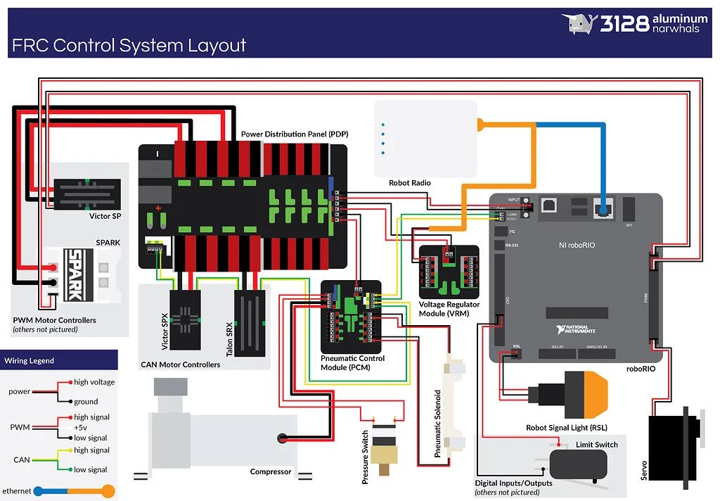

Step 3: Wire Up Electrical
Taking your Power Distribution Panel, plug your motor controllers from your chassis into the corresponding points on the board. Make sure all connections are solid and use the power pole connectors when going between two components (ex: between motor controller and dist panel, and between motor and motor controller).
Take this time to also set up your battery, by connecting the battery connectors and insulating all connectors (you can use electrical tape for the terminals on the battery)
Once your motor controllers are attached follow the wiring diagram to connect your RSL, Roborio, Radio, and other electrical components ( you can ignore the pneumatic generator)
(credit for image and help form attached below)

Step 5: Attach Electrical and Set Up Power Board
Using an electrically isolated material (Polycarbonate or Plywood) attach the main power components and controllers to the board.
Double-check all your electrical work with wiring instructions provided through https://www.youtube.com/watch?v=lGgIhxYuSHM&t=1s and various diagrams on FIRST's website until you have everything from the RSL to the pneumatic control module all wired up and electrically isolated from the rest of the cassis
