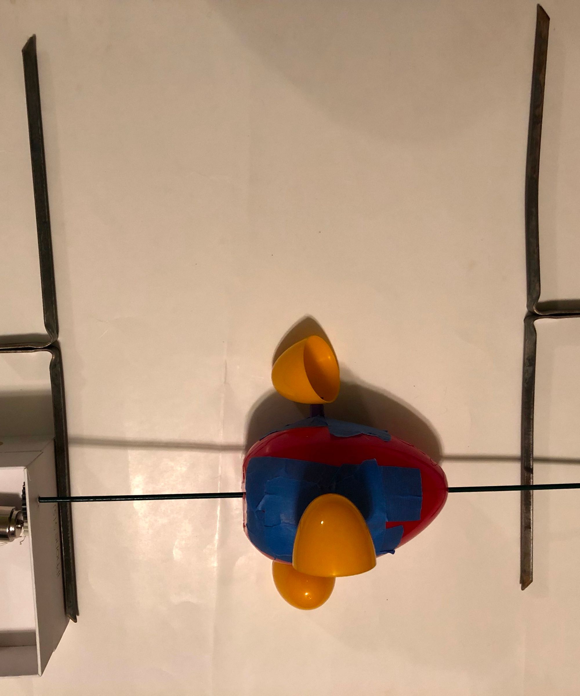

In this case, our goal was to make a robot that could use various methods of Arduino programming to drive down a hallway, powered by a remote controller, and then, without the remote controller, find its way back to the goal and push the ball into the goal. With this goal in mind, we could then move onto the next step in the project. Our only limitation for this project was that the overall price could not be more then 75 dollars.

There is not really much to say about this aspect of the project part, but some safety tips on tools. When in the workshop, always wear glasses and gloves and an apron. Taking these precautions have saved countless lives and injuries. Some equipment we used in this case was a welder, a band saw, drill press, and other metal working tools. Also, before you weld, make sure what you weld is 100% correct because there is no going back.
