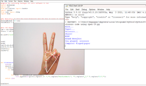

This project uses OpenCV to leverage the power of computer vision, allowing users to play the classic game of Rock, Paper, Scissors against a computer opponent. Using the OpenCV library, this project employs image processing techniques to capture and analyze hand gestures in real-time. Users can interact with the system's webcam by making gestures with their hands, and the computer will respond with its own randomly generated choice, and then processes the data to decide a winner.
In this tutorial I'll go in over how each part of the code works so it's pretty beginner friendly, but the full code is also linked at the bottom for reference.
This program is run using IDLE for Python, as well as Open CV for gesture detection. You also need to have a camera on your computer to collect the video data.

in the 'if' conditionals, basically all we're doing is determining what fingers need to be raised to meet the criteria for each gesture. For paper, it's all four fingers; for scissors, it's the index and middle; and for rock it's none of them. In addition to that, you need to take into account the computer's result, and for each possible combination create print statements to display the results of the round (feel free to modify these).
At the end of each 'if' statement, note that we add the statement 'counter=counter+1'. Initially, we set the counter value as 0, but if it detects a hand gesture then it changes to one, deferring it to the last 'if' statement where we implement a sleep statement to delay the code. By doing this, we create a break of 10 seconds before the next round of the game starts and the camera begins detection again.
