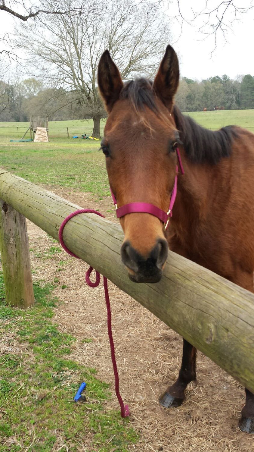

Introduction: Rope Halter With Fiador
A rope halter is an invaluable training aid. Customize for any size horse, baby to full grown. With this easy step by step guide never buy a rope halter again and always have one on hand for emergencies.
The one with orange is a foal halter I made for our new little girl.

Step 5: The Fiador Knot (don't Run Away)
This took me two days to learn. I found these pictures (the blue rope) on Wikipedia, best example I found anywhere of the fiador.
It might be easier to learn this knot on 550 cord of a shorter length. That's what I did.
Start the fiador 7 to 8 inches down from the double over hand knots.
When the fiador is done you should have the nose loop with two double over hands and below, two loops of 3 inches or so.

Create a bend in the 550 cord. Begin wrapping the cord from the ends of the halter rope back. Once you have finished wrapping, feed the end through the loop you created. Wrap the other end around your make shift marlin spike and pull the loop and remaining cord back into itself.
Step 10: Tips
Leave you knots loose at first. Put your new halter on your horse and adjust before tightening.
After adjusting, then whip the loose ends.
The measurements I used are for a quarter horse and are a good starting point.
Use one of your horse's halters for easy measuring (mine wouldn't stand still for my tape measure).
And last, use the scrap to make a short lead. Just double it over, slip it through the fiador loop and pass the ends through.
