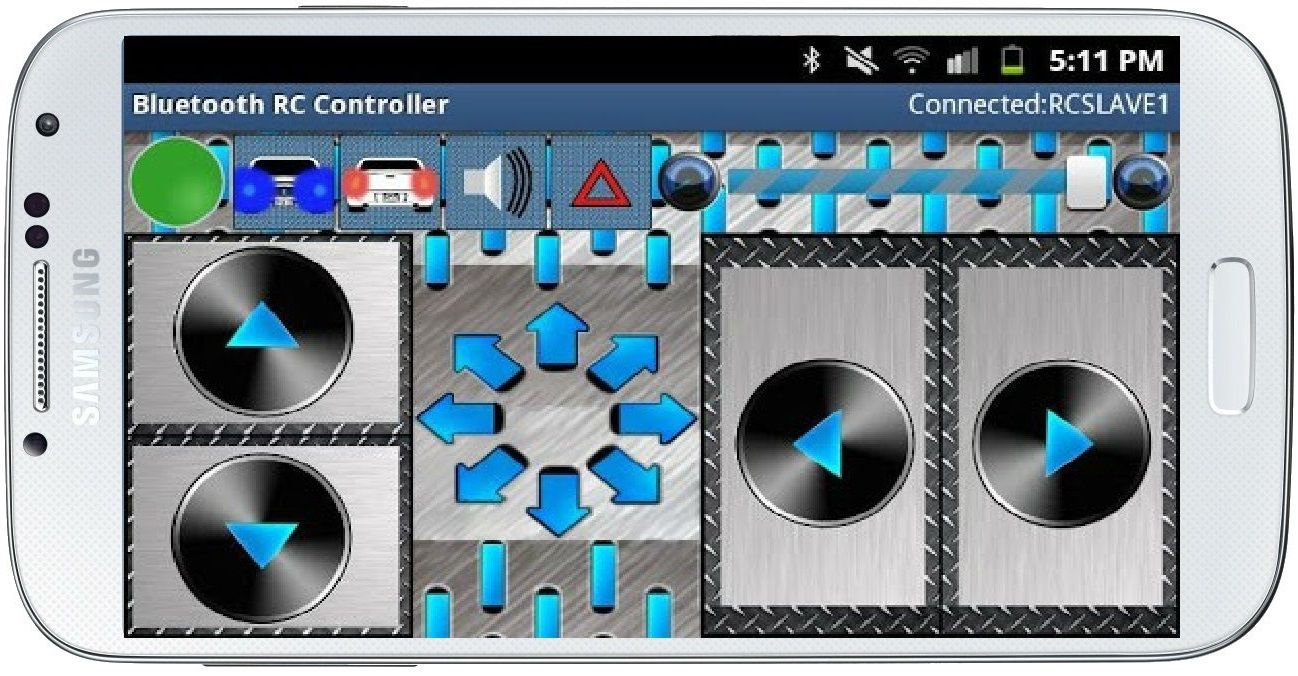

Step 13: The Android APP Interface
______________________________________________
Steps/ Procedures:
1st.) Download App in google play
2nd.) Turn your bluetooth on, and open the app
3rd.) Establish a bluetooth connection betweeen your phone
Go to Settings> Press Connect> Press LINVOR (Your BT Device)
4th.) Wait for the red light to turn green. And Your'e Done!
