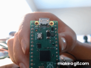

Connect 1 square head jumper wire to the VSYS and another to the GND next to it.

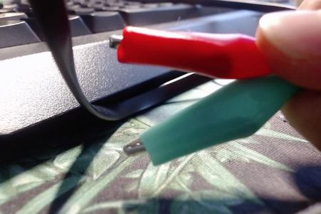

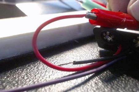

Connect a red alligator clip wire to the red jumper wire. I don't have a spare black alligator clip wire, so I used green. I highly recommend you to use matching colors, otherwise you might be confused. Anyway, connect the a black alligator clip wire to the black jumper wire.
Step 4: To the Battery

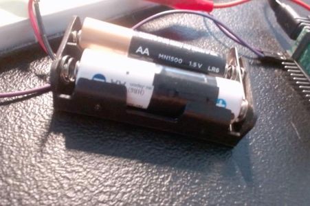

Connect the red alligator clip wire to the red wire of the battery box. Then, connect the black alligator clip wire to the black wire of the battery box.

Finally, put in the batteries and type in the code. Click run before you remove the USB, and when you want to stop running the code, disconnect one of the jumper wires. Enjoy! Oh, yeah, also keep in mind that this will work on any kind of code.
