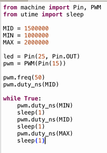

Step 4: Code
Copy this code into your Thonny window and click play. See your servo run!
