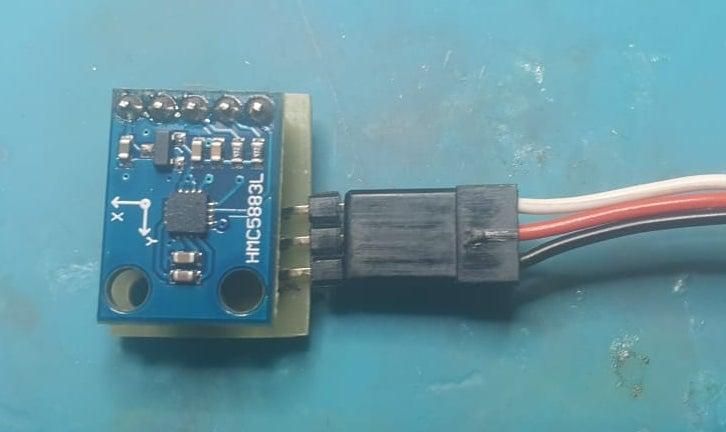

Step 1: SBUS to PPM Converter for the ESP8266 (ESP01)
The ESP01 is nicely suited for this task because it’s cheap and we only need a serial port for the SBUS stream and a digital port for the output. Be warned that the digital output ports in the ESP01 will spit some data at strange serial speeds during the first 100mS of initialization immediately after power up. The USB R/C dongle I used for testing is not affected by the bogus initial data. If your dongle does not work or stops responding during startup try turning your radio off and then on (which will output a LOW PPM reset signal). Use another MCU if that doesn’t fix the problem.
As you know, we have to be creative to take advantage of all ESP01 ports, since pulling down on GP0 or GP2 will prevent the MCU from booting from flash. As you can see, the LED (D1) which has the cathode connected to a resistor coming from 3.3V is actually pulling up on the port (the LED is active LOW). Also, the PPM_OUT pin, even being an output, must have an external pull up resistor (R4). That’s because GP2 is an input until the program starts, and obviously the program cannot execute the pinMode(2, OUTPUT) instruction until after is has started. As an additional precaution, R6 is there just in case the ESP8266 tries to output something during boot, before turning into an INPUT. As a matter of fact, when we initialize the UART and before repurposing the port for the configuration jumper, TX is an output.
The component mounting photo is a bottom view while the PCB is a top view. The unpopulated resistor pad is there in case we needed a 4K7/10K voltage divider for the 5V signal from the receiver, which it seems, is not necessary.
All resistors and capacitors are SMD 0805. You can use this template to build the device in a perforated board (see prototype photos). The ESP01 used is a 1Mb version (nothing is saved to the filesystem, so, the infamous PUYA chip will be no problem). You don't need more flash (like the ESP01S' 4Mb) for this project.
If you don't make the ESP01 PCB above, you will need to build the 3.3V inverter found in PART 1 of this instructable series.
The following sketch will work in ESP01, ESP12, nodeMCU, Wemos D1 mini, etc.
