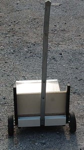

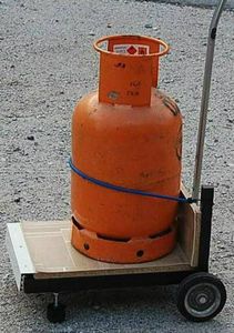

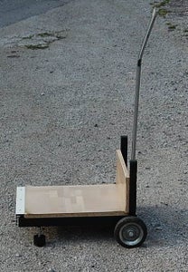

My friend asked me if he could do an easy stroller to transport gas cylinders or small things. I've used materials, which people usually discarded.

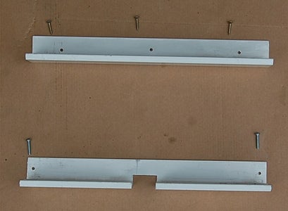

3.angle profile 2 piece 35 x 55 x 320 mm (residue from the institution curtain)
3.1.kniping screws 2 pcs fi 3.5 x 20 mm
3.2.wood screws 3 pcs Ø 3.5 x 20 mm

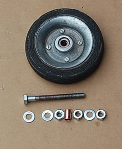

4. wheels 2 pcs fi 130 mm
4.1.screws 2 pcs M10 x 100 mm
4.2.nuts 6 pcs M10
4.3.washers 2pcs screw M10
4.4.spacer bushes fi 10.5 / 14 x 40 mm

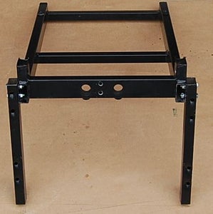

6.profile 2 pcs 20 x 30 x 280 mm
6.1.screws 4 pcs M6 x 35 mm
6.2.nuts 4 pcs of M6

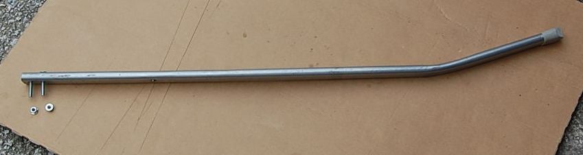

9.carrier profile 20 x 40 mm (residual)

1.In the carrier profile is drilled on each side of the hole Ø 10.5 mm, for screw M10 - wheels.

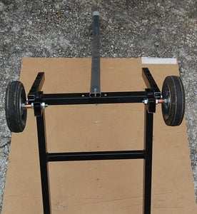

2.Profile 20 x30 mm furring and mark the location for 2 bore Ø 6,5 mm. Drilled holes.
3.labeling location for the holes on the carrier profile and drilled 2 holes Ø 6.5 mm on each side for mounting profiles 20 x 30 x 280 mm.
4.Profile mounted on each side with 2 screws M6 x 35 mm with washers and nuts.
5.On the back of the profile is drilled two holes for screws M6 - for mounting the holder.
6.On holder drill 2 holes for M6 thread.
7.Fix each side profile of 20 x 30 x 280 mm, with screws M6 x 35 mm.
8.Fix bracket with 2 screws M6 x 40 mm.
9.Fix wheel bolts M10 x 100 mm.

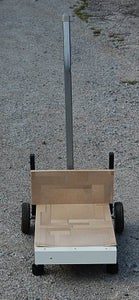

10.Fix angular profile with a groove 35 x 55 x 320 mm (residue from the institution) curtain) with 2 screws kniping fi piece of 3.5 x 20 mm.

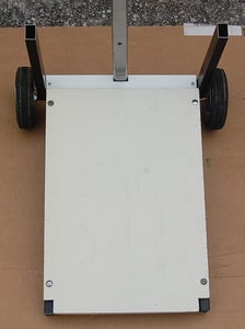

11.Fix particle board 470 x 320 x 20 mm with kniping screws 4 pcs Ø 6 x 40 mm.
12.Fix on the front part of the angular profile of 35 x 55 x 320 mm with three wood screws.
13.FixPVC legs with screws 2 pcs M8 x 100 mm.
14.Insert PVC caps in 2 vertical profile.

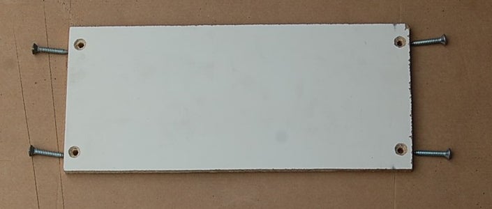

15.Fix particle board 365 x 160 x 15 mm with kniping screws 4 pcs Ø 6 x 40 mm.

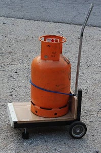

16.Paste PVC canvas 2 x
Cart is ready for transport. The gas bomb still fixed by elastic tape.
