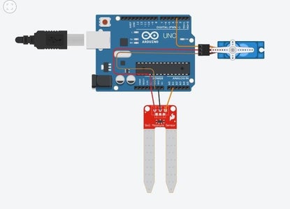

Step 1: Assemble the Hardware
Connect the Arduino Nano to the soil moisture sensor and the micro servo motor. Ensure proper wiring and power connections. Wiring and the schematics given above are on the Arduino r3 board but the connections will remain the same for the nano board as well as for the mechanical servo motor. Link to the circuit and code on Tinker cad.
Step 2: Programming the Arduino
The above circuit link also includes code in it which you may copy. You may copy from below. 👇.

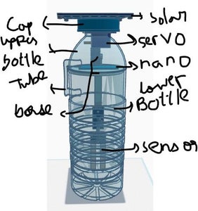

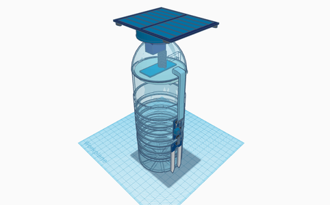

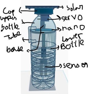

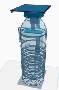

Step 3: Mechanical Design
Link to the 3D model on Tinker Cad. Create a secure housing for the components. Follow the 3D Model design above to build the project( don't mind my handwriting)
1) Cut the conical half of the bottle.
2) Connect the halves with a pipe(connect it as shown above) (NEVER FILL THE UPPER HALF ABOVE THE PIPE LEVEL)(IMPORTANT)
3) Cut a hole in the bottle cap to fit on the servo and fix the bottle so that it doesn't rotate along the cap.
4) Insert all the electronics inside the upper half and fix the solar panel on the lid.
5) Insert a piece of plastic between the 2 parts and seal it using a soldering iron.
6) Ensure the servo motor can access the water bottle cap. Test the mechanism to ensure smooth operation.
7) Cover the sensor with tin or aluminium foil to avoid corrosion of metal on the sensor
8) Place the sensor in the roots of the plant
9) Aim the drops over the plant's base.
10) Seal the bottle with clay or glue gun wherever required. Seal the lower half with clay so that you can fill it when empty
11) Give servo a strong base
12) PUT A HOLE BELOW TO INSERT PIPE TO ALLOW WATER TO FLOW ( NOT INCLUDED IN DESIGN) (DON'T ACT DUMB LIKE ME)
