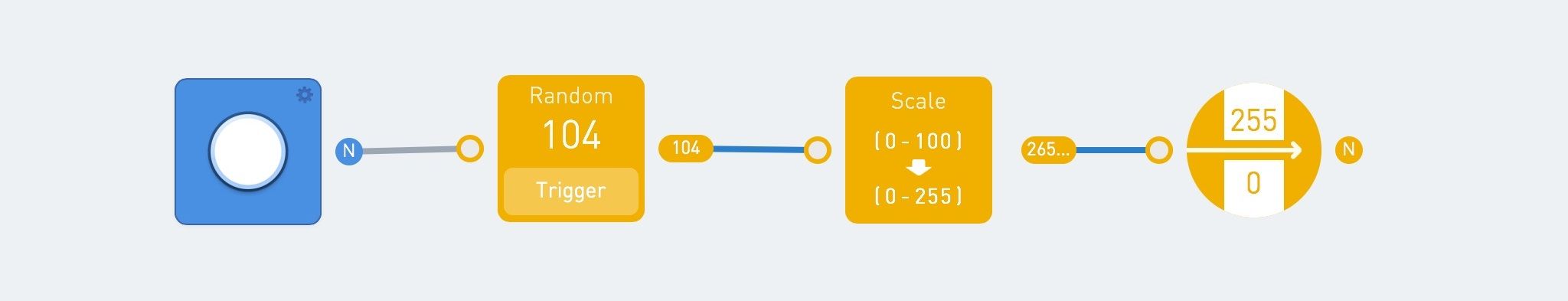

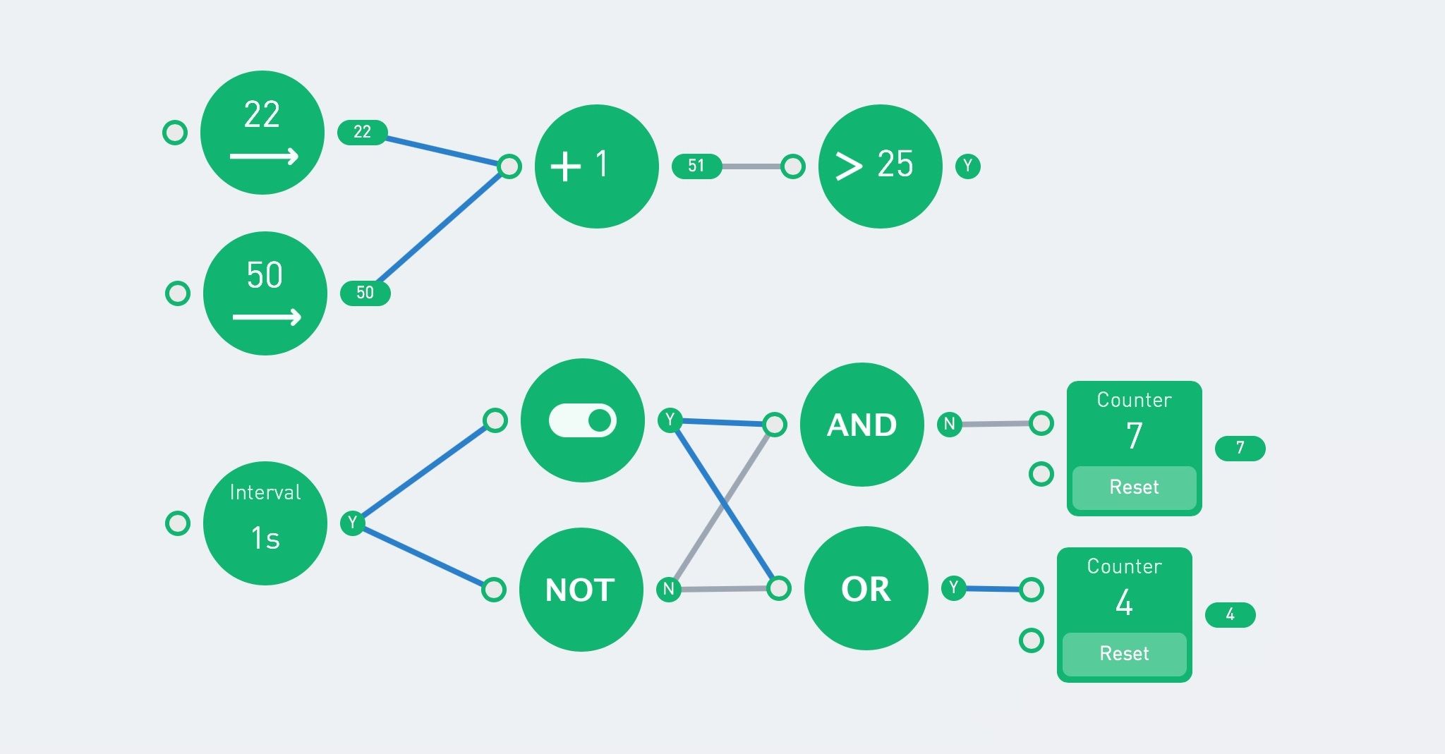

Logic and Math
These are basic functions. And have one or two inputs and one output value. There are several simple calculations and comparisons.
The toggle function switches it's state each time it receives a 'Y'.

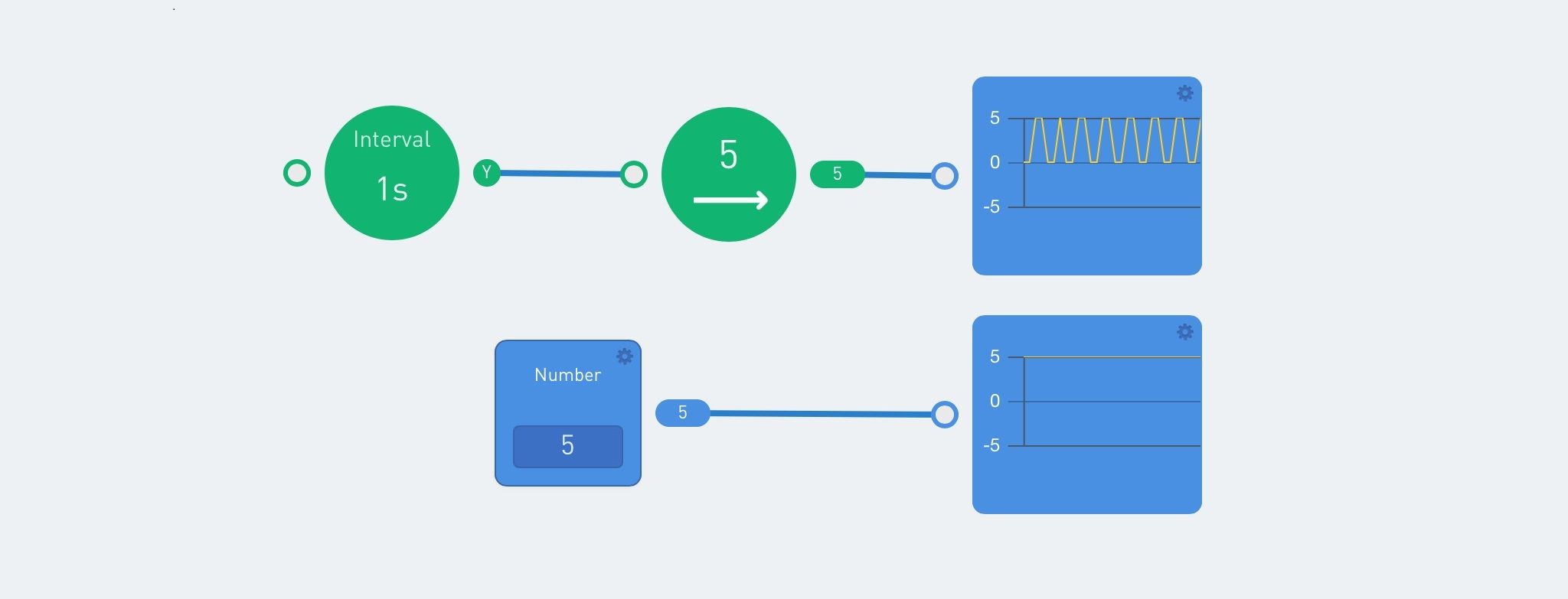

Numbers
There are two number nodes, one "basic" and one "controls" version (they are on different tabs). The controls version is a fixed number, while the basic number has an 'on' and 'off' state. The following example shows the difference. The interval switches on ('Y') and off ('N') each second. The output of the green number is 5 when the input is 'Y', else the value is 0.
The curve node shows a graph. That is useful to show the different output values. Other useful indicators are the label and indicator node.

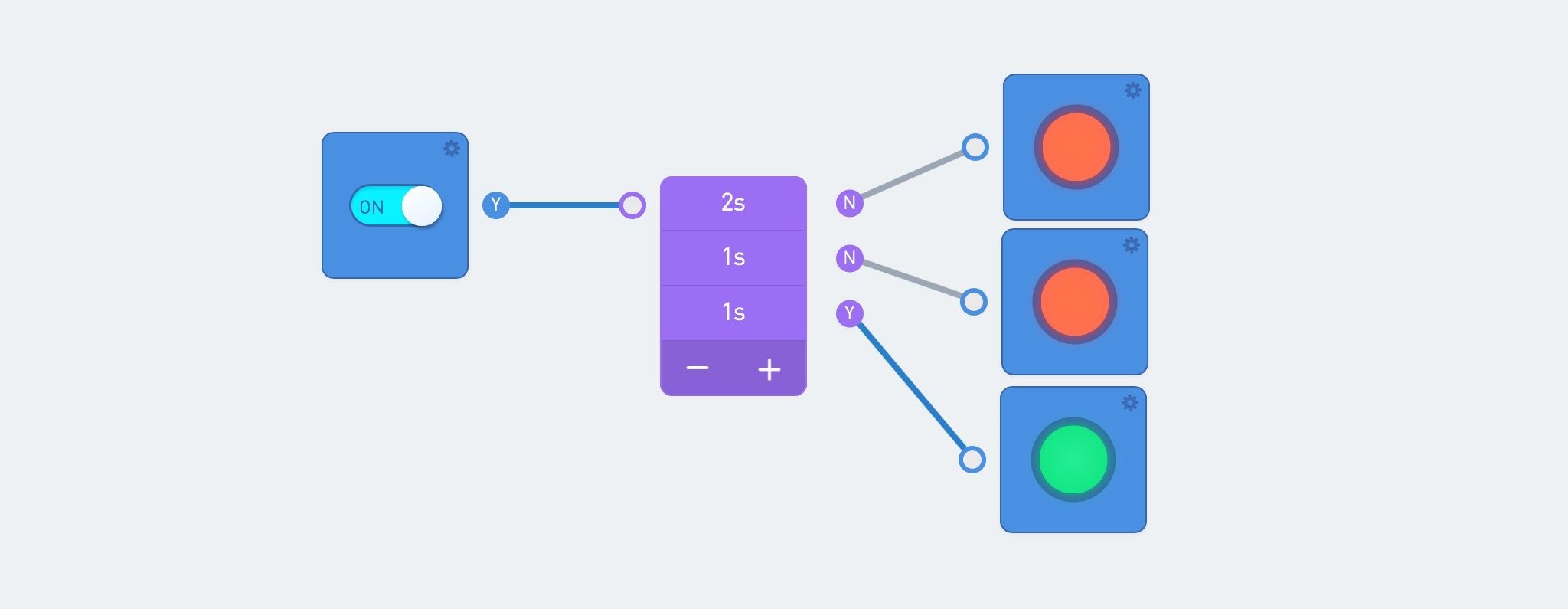

Sequence
The sequence runs repeated or only once when the input is 'Y'. This allows for a sequence of actions.
The sequence gets a signal when the switch is turned on. The output of the sequence is passed to an indicator.
Note the color of the lines: The blue lines indicate the current flow. And the circle to the right of a node always shows the current output.
Scale
The scale node translates an input range to an output range. For example 0 to 100 can be translated to a value between 0 and 255.
Values above the maximum of the input range result in a value higher than the maximum output scale! The filter can be used to limit the value.

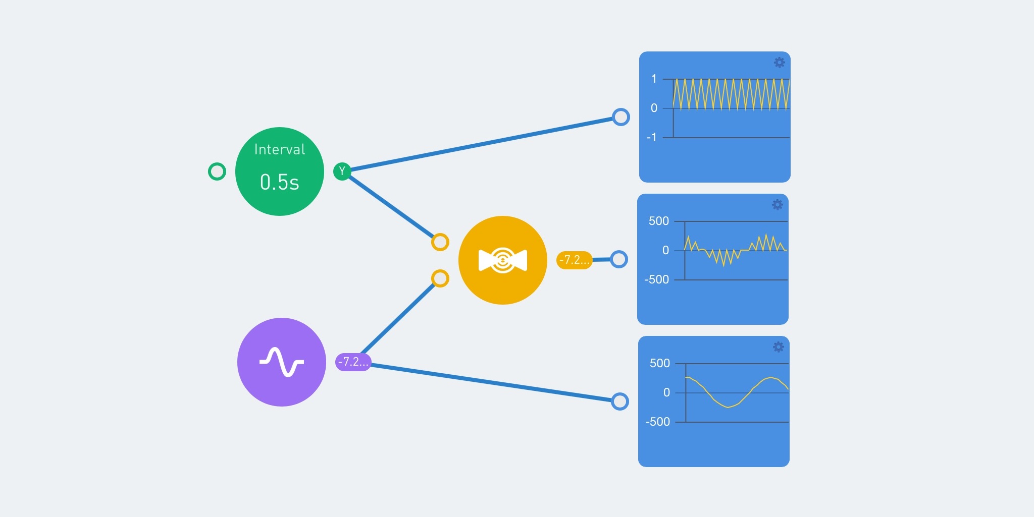

Valve
This is an node which passes the lower input value if the upper input value is true. This is best explained with an example:
The green interval node switches between 0 and 1 each half second. The ouput of this node is visilbe on the uppper graph. The purple pulse node gives a sinus output, with values between -255 and 255. This is shown on the lower graph.
Both the interval and sinus are input for the valve node. And the output value is 0 when the interval value is 'N'. When the interval value is 'Y', the output value equals the sinus input value. This gives the middle graph.

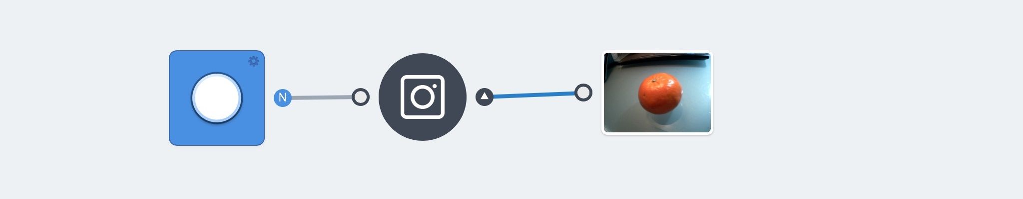

A camera tab and icon appear inside the app when the camera is attached to the WiFi block. The icon opens a preview window with the camera's image.

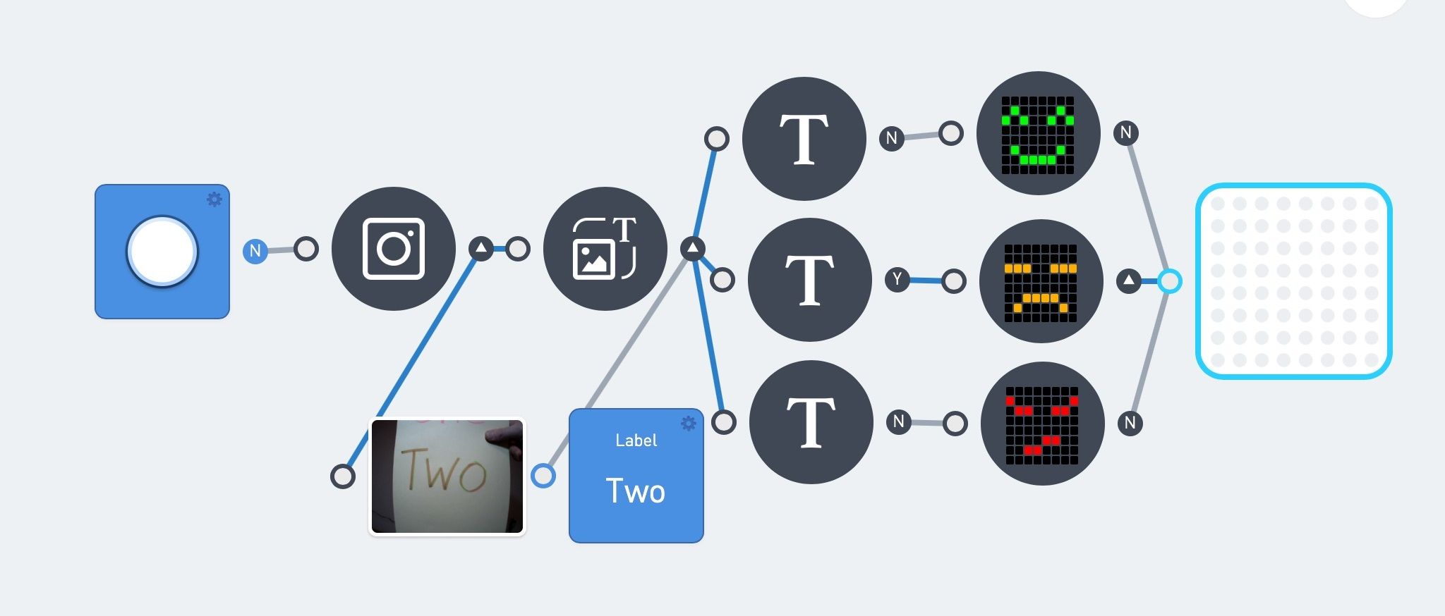

There is a photo/camera node inside the camera tab. This takes a picture when there is an input signal with the value 'Y' (true). After placing this node in the program area it has three options (click on the node):
- Photo Frame
- OCR
- Emoticon Test
The photo frame shows the output of the photo node. The next three nodes provide a "photo camera". The camera takes a picture when the button is pressed (this gives 'Y' as output). And this is shown inside the photo frame. The image is stored inside the WiFi block, but is overwritten when a new photo is taken.
It is posible to use the timer for input to the camera, but don't make the interval too short (> 1 second). Else the WiFi block can't handle the data, and hangs for a while.
The OCR node translates images to text. This uses the Microsoft cognitive services. The WiFi block must be connected to the internet, and the App must be connected to the WiFi block.
The next program takes a picture when the button is pressed. This photo is displayed and processed by the OCR node. The output is compared by three text-compare nodes. These check for the values "one", "two" and "three". And each value shows a different image on the LED panel. The output of the OCR node is also displayed by a "label" node. This shows "No" (False) when nothing is recognized.
Blue lines indicate the data flow inside the program. And the 'Y' and 'N' after each node represents it's output value. This simplifies troubleshooting within a program. Unfortunately, the output of the LED matrix is not displayed in the App.

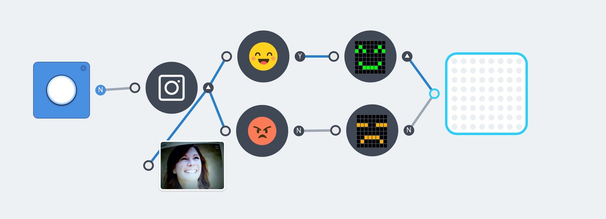

The final camera node option is the emoticon test. This translates faces on an image into a emotion.
The above examples are simple, but they show the basic principle. Extra logic and neuron blocks can be added to create more complex programs

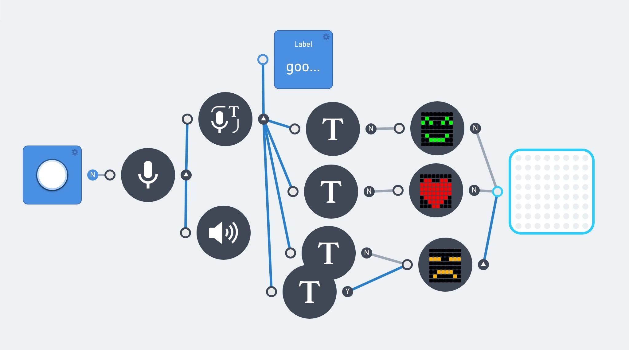

Step 8: Voice Recognition (Microphone)

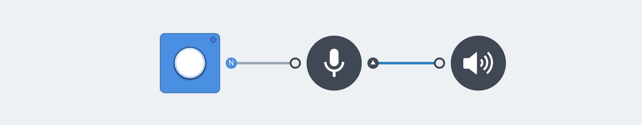

In addition to the camera, a microphone / speaker Neuron can be connected to the WiFi block. This can be used to record and playback audio fragments. Connecting this Neuron gives an additional "sound" tab in the App.

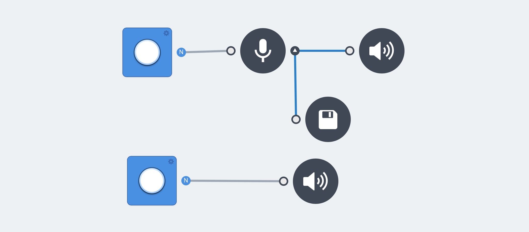

The record node will only record sound if the input is "Y', this requires a button or switch. The recorded audio fragment is the output of the record node. Adding the "play sound" node immediate plays this output. This can be used to make a parrot:

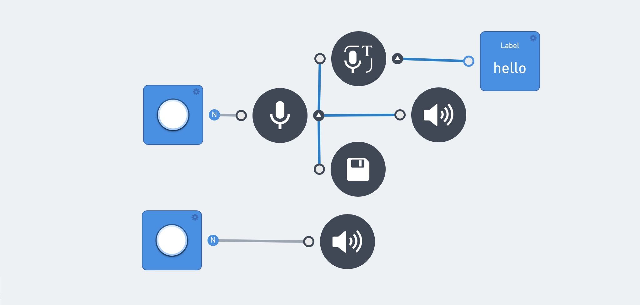

Clicking on the microphone node gives 2 options: "voice to text" and "save record".
The "save record" node saves the audio file on the filesystem inside the WiFi Block. This file is overwritten each time a new recording starts.
The "Play sound" node is capable of playing input audio, but it's also posible to select a sound effect or recorded file. It requires an input trigger to start the given sound. And it stops immediate when the input is 'N' (false). The following example is a kind of dictaphone. The upper button makes a recording and the lower button plays this recording.
The voice to tekst option of the microphone node uses Microsoft cognitive services to translate the recording to text. The label node is capable of displaying the output. The record and play sound nodes aren't required to translate voice into text. But these are useful during programming to check the output.
Debugging of this feature can be done by logging into the WiFi block (advanced feature).
[2018-01-19 23:00:35] [WARN] Request handler 'sound server' was called: {"command":"startRecord"} [2018-01-19 23:00:35] [WARN] start record [2018-01-19 23:00:38] [WARN] Request handler 'sound server' was called: {"command":"stopRecord"} [2018-01-19 23:00:38] [WARN] stop record [2018-01-19 23:00:38] [WARN] Request handler 'sound server' was called: {"command":"speakerRecognize" ,"fileName":"/tmp/tmpRecord.wav"} requestSpeech result: it's a nice day
It's posible to check for multiple words. And the compare node works just like the camera OCR.
Sometimes the same word gives different output. For example: "goodbye" might give one of the following values: "good bye" or "goodbye". This requires multiple text nodes with the same output:
Note: The default speach to text language is English.
