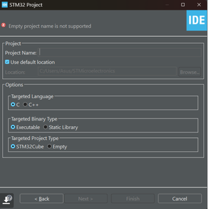

Step 1: Create a Project File on STM32CubeIDE
  • Type the project name.
  • Choose your preferred programming language, binary type and project type.
  • Choose "Add necessary library files" for less errors and problems.

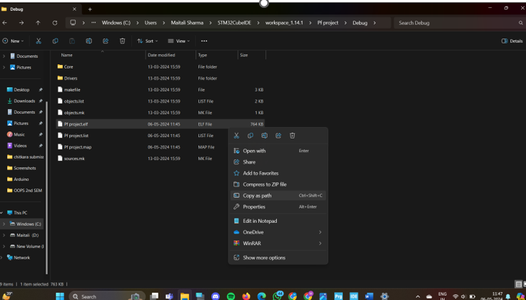

Step 4: Open the Project File in File Explorer
  • Copy the path of .elf file.
