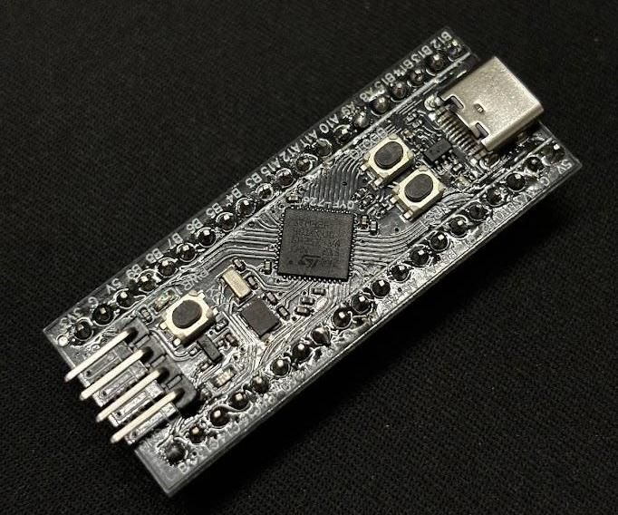

Hardware:
  • STM32 Black Pill
  • 16*2 I²C LCD
  • Laptop or desktop
  • USB-C cable
  • Few jumper wires

Step 1: Project Creation
  • Create a new STM32 project from File > New > STM32 Project
  • Select the appropriate board.
Step 2: Pinout Selection
  • Go to Connectivity > I2C1 and enable it. This will set SDA to pin 43 and SCL to pin 42.\
  • Go to System Core > RCC > HSE > Crystal/Ceramic Resonator.
